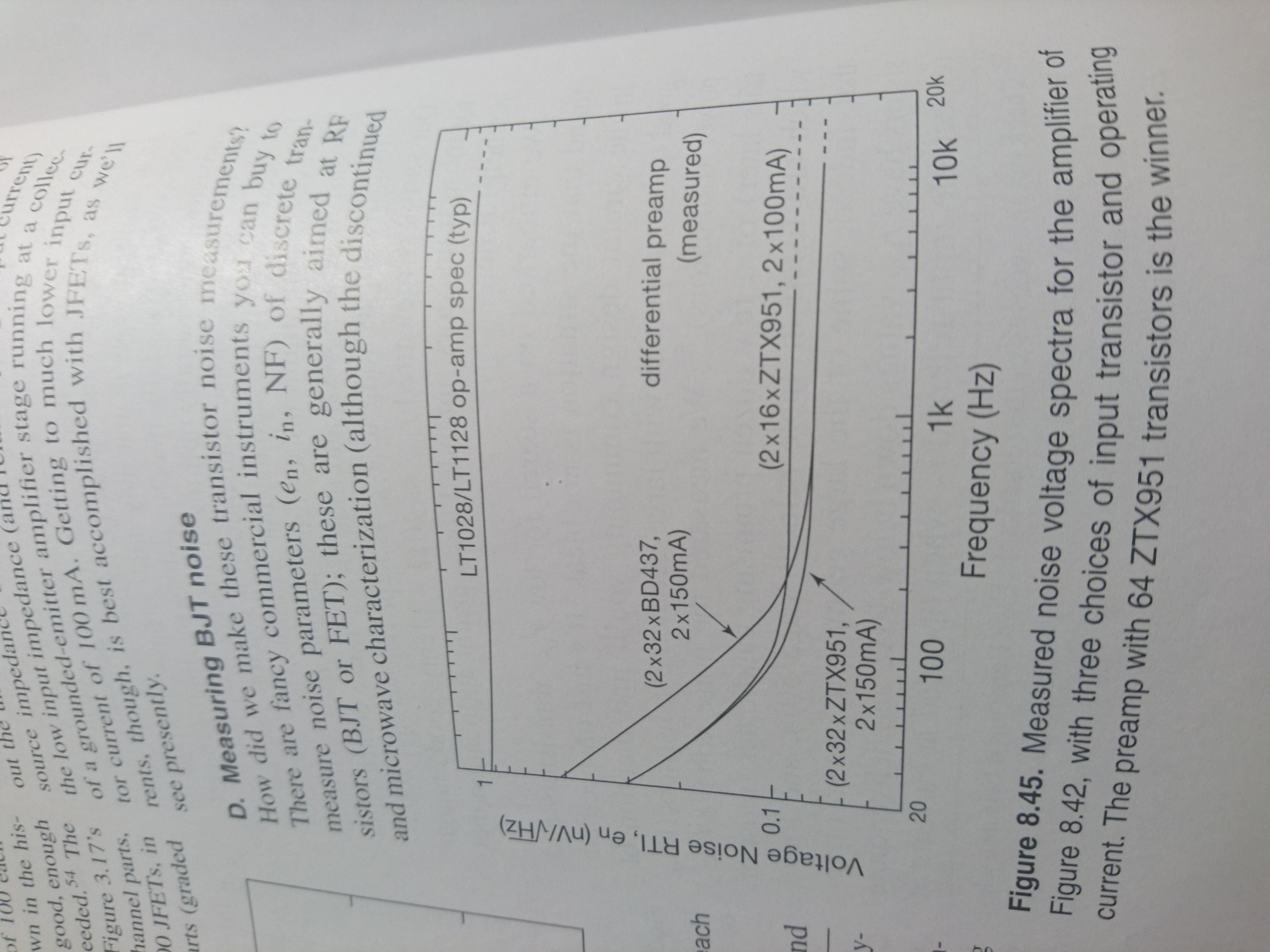

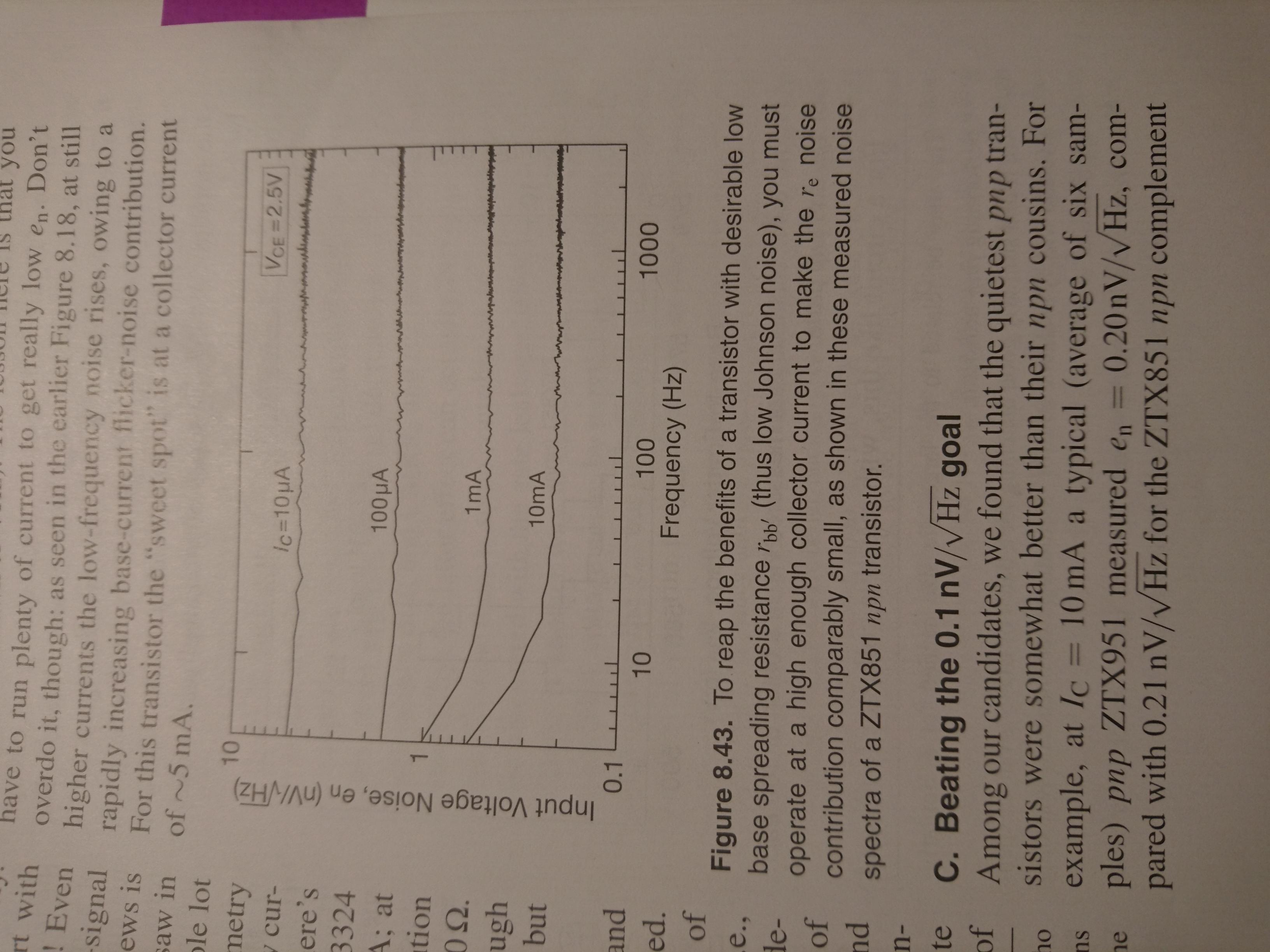

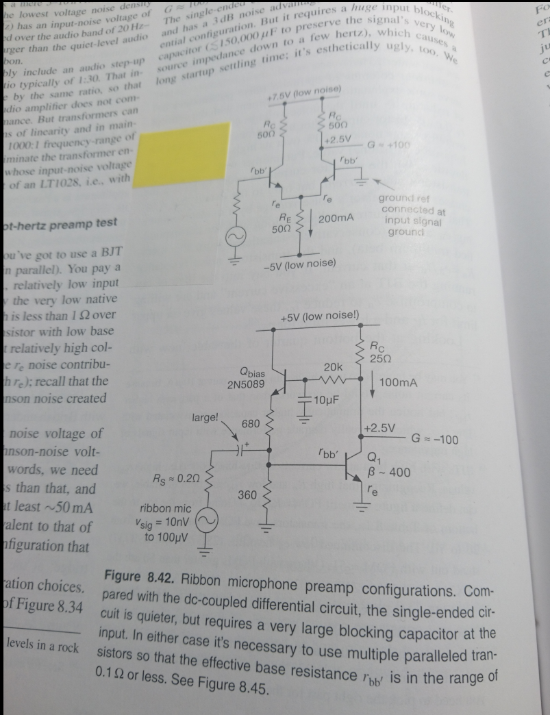

No, 8.42
These small excerpts must be enough.
I don't want that Winfield kills me next time I meet him on s.e.d.
The book is nearly 1200 pages of really good information.
Worth every cent.
