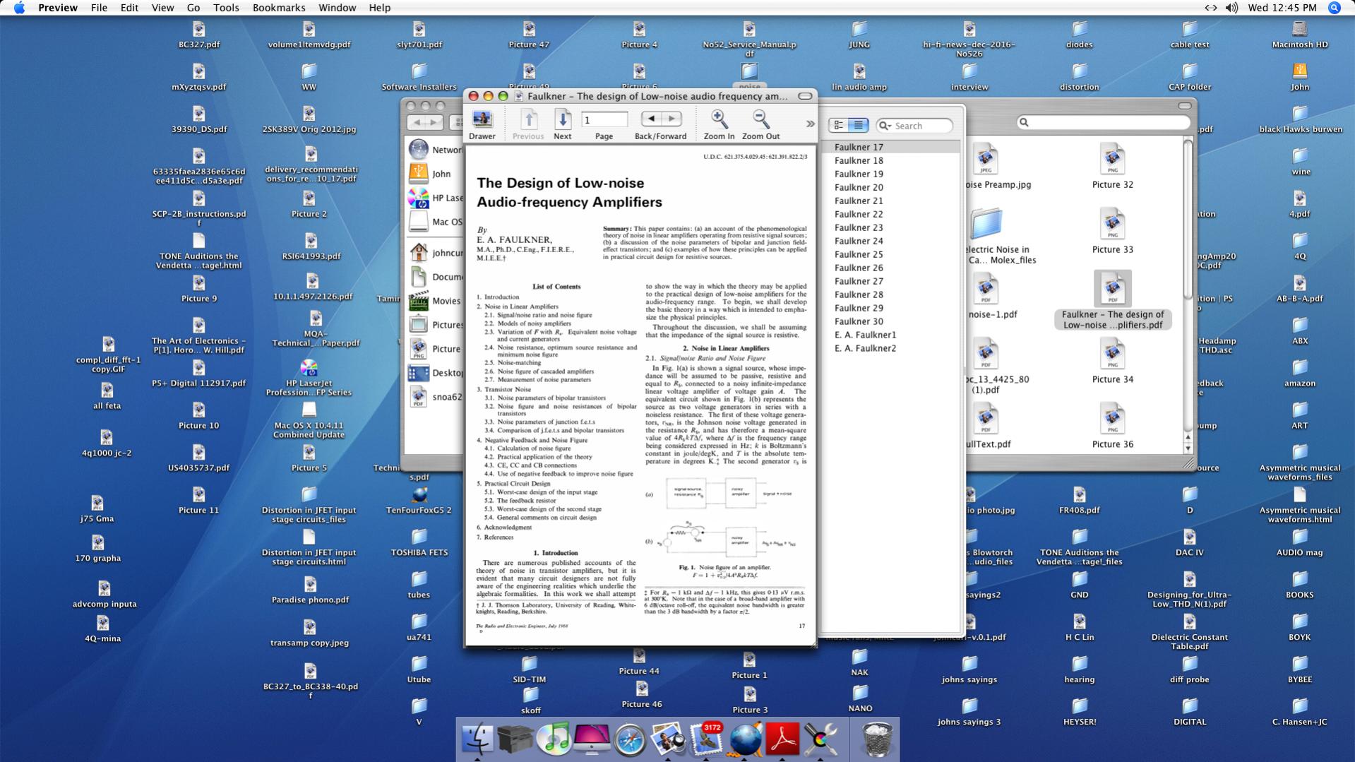

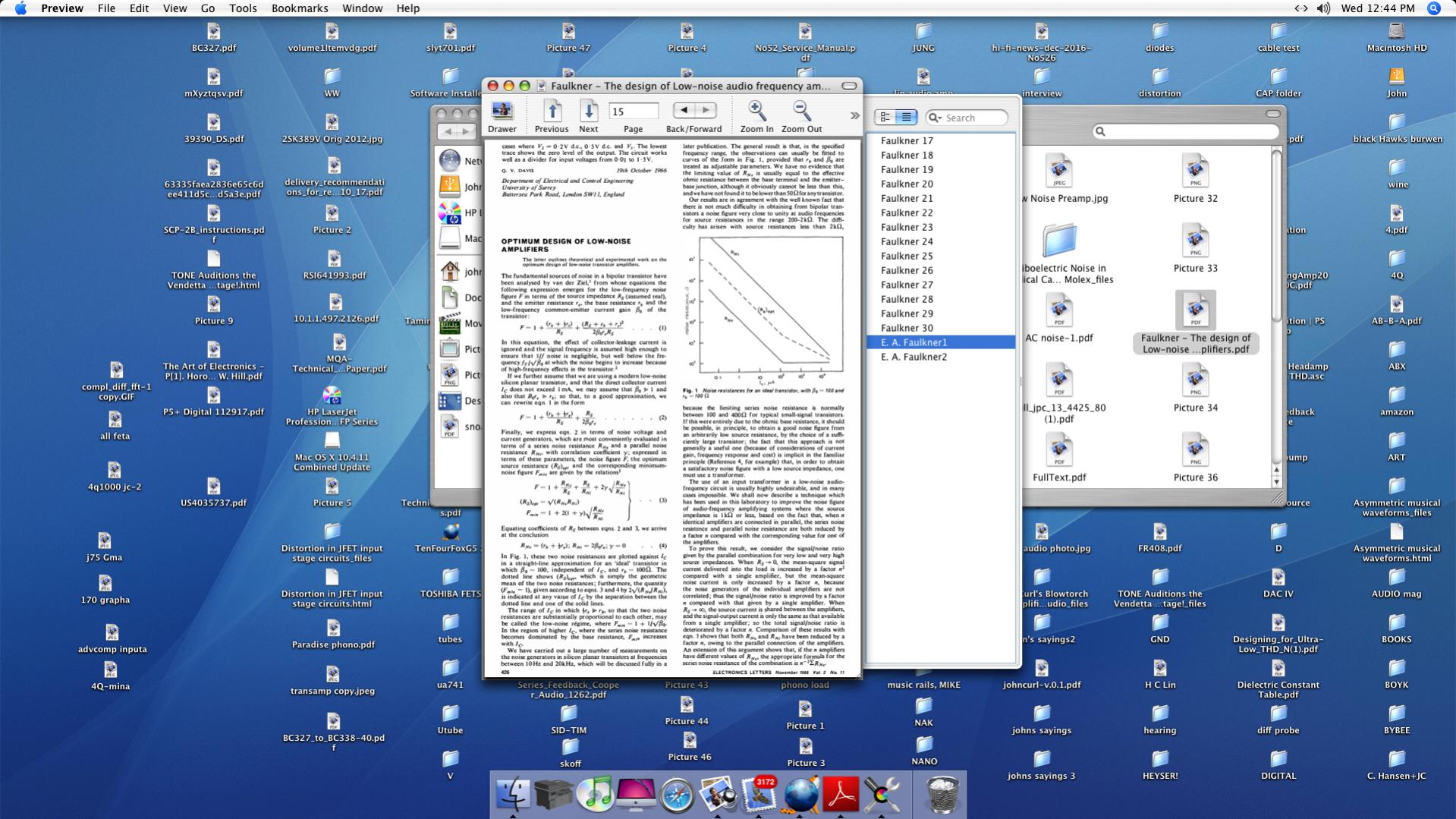

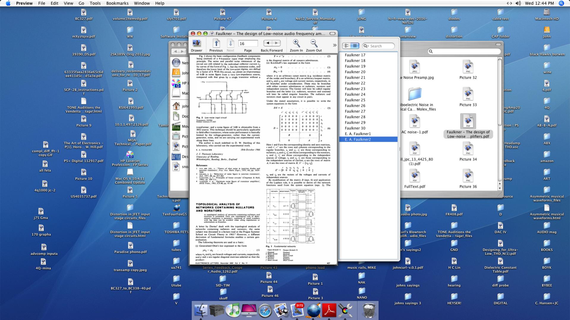

Now I am somewhat of an exception to many of you. For example, I started looking into ultra low noise design about 50 years ago, and I was able to move forward, even then, because I had access to a QuanTech transistor noise analyzer at Ampex where I worked at the time. I was driven to find out everything that I could about low noise design, because I wanted to replace the simple Ortofon phono cartridge transformer (X50 gain) with something solid state. I already knew that in principle that it could be replaced, but LOW Rbb' devices were not specified at the time. 49 years ago, I found the 2N4401-3, and the 2N4405 Motorola transistors to actually have a much lower Rbb' than virtually any 'low noise' rated transistor at the time, and I knew about paralleling them from an earlier paper in 'Electronics Letters' that gave me the hint. However, just paralleling single sex parts makes for marginal electronics circuits, and I wanted more. It took literally years before I developed the Levinson JC-1 circuit that actually had 0.4 nV/rt Hz or so noise in 1973. People could not believe it at the time and insisted that we must have used a transformer. Of course, we just used 8 noise paralleled devices to get the low noise floor, OBVIOUS NOW, 44 years later. We patented the circuit, but Ortofon and others just stole the circuit from under me. So much for patent protection.
Here is a later source of my original breakthrough by the original author in
'Electronics Letters'.
