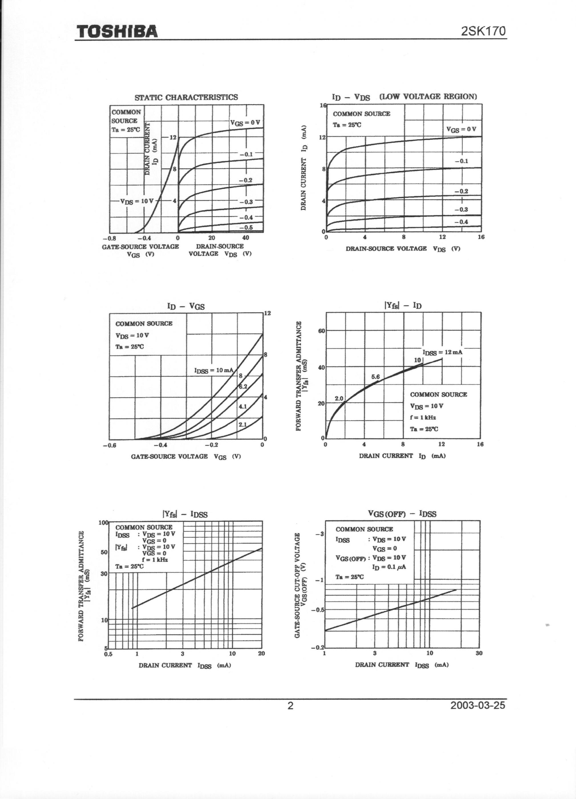

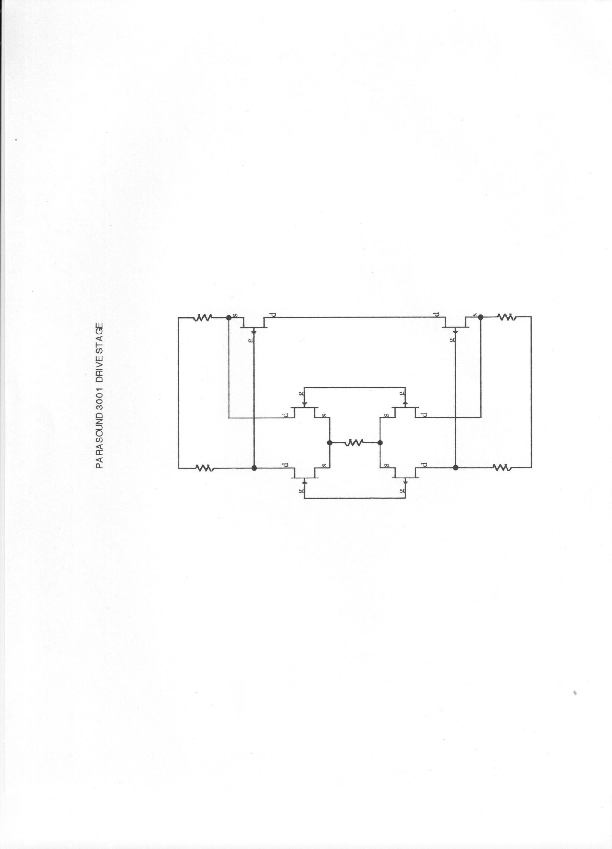

Now here is an excellent example of a jfet data sheet which will give us a great deal of information as to how this device will mate with a 'complement' jfet and other useful characteristics. Also, here is an example of the same JC-2 sort of circuit made with all fets. Either jfets or mosfets can be used for the second stage.

It seems to me, that circuit needs PJFETs and NJFETs that are gm matched , rather than IDSS matched. IDSS matching simply means that the midpoint of the shared source "tail" resistor, is exactly zero volts. But if the gm's are not matched, you'll get distortion in the second stage because the push- (PJFET) and the pull- (NJFET) currents (the signal currents) are not equal.
Maybe people actually do want the push- and the pull- signal currents to be equal, so they actually do want gm matching ... BUT it's so much easier in the lab to measure IDSS than to measure gm! Maybe people take the easy way out: measure and match IDSS. And then they hope that IDSS-matched devices will also turn out, by the grace of God, to have pretty close gm too.

PS, why not try something like Samuel Groner's fully-complementary transimpedance stage on even larger rails with the appropriate bootstrapped cascoding of the diff pair and even more (wasteful) resistance in the current mirror (as to push the noise down further). Then go crazy with gm/c and noise in the input pair.
Surprisingly having built the basic gain stage using Mosfets for the second stage it sounds quite good. Distortion was also low .01% ish as I recall.

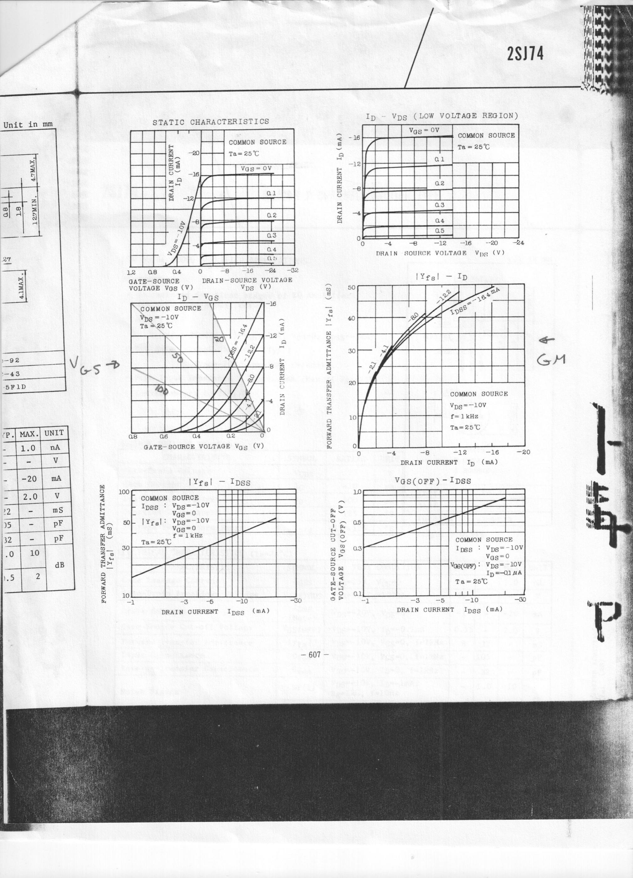

Mark Johnson makes a good point, although not a super important one, because many 'useful' complementary jfets for this application have similar Gm at the same approximate current. For example, compare the 2SK170 with its complement, the 2SJ74. Look at 2 ma for example or another current. The Gm's track pretty well. Even if the Gm's are slightly off, this can be compensated for with some local feedback on one pair, or you can just ignore it and put up with a small increase of distortion.
