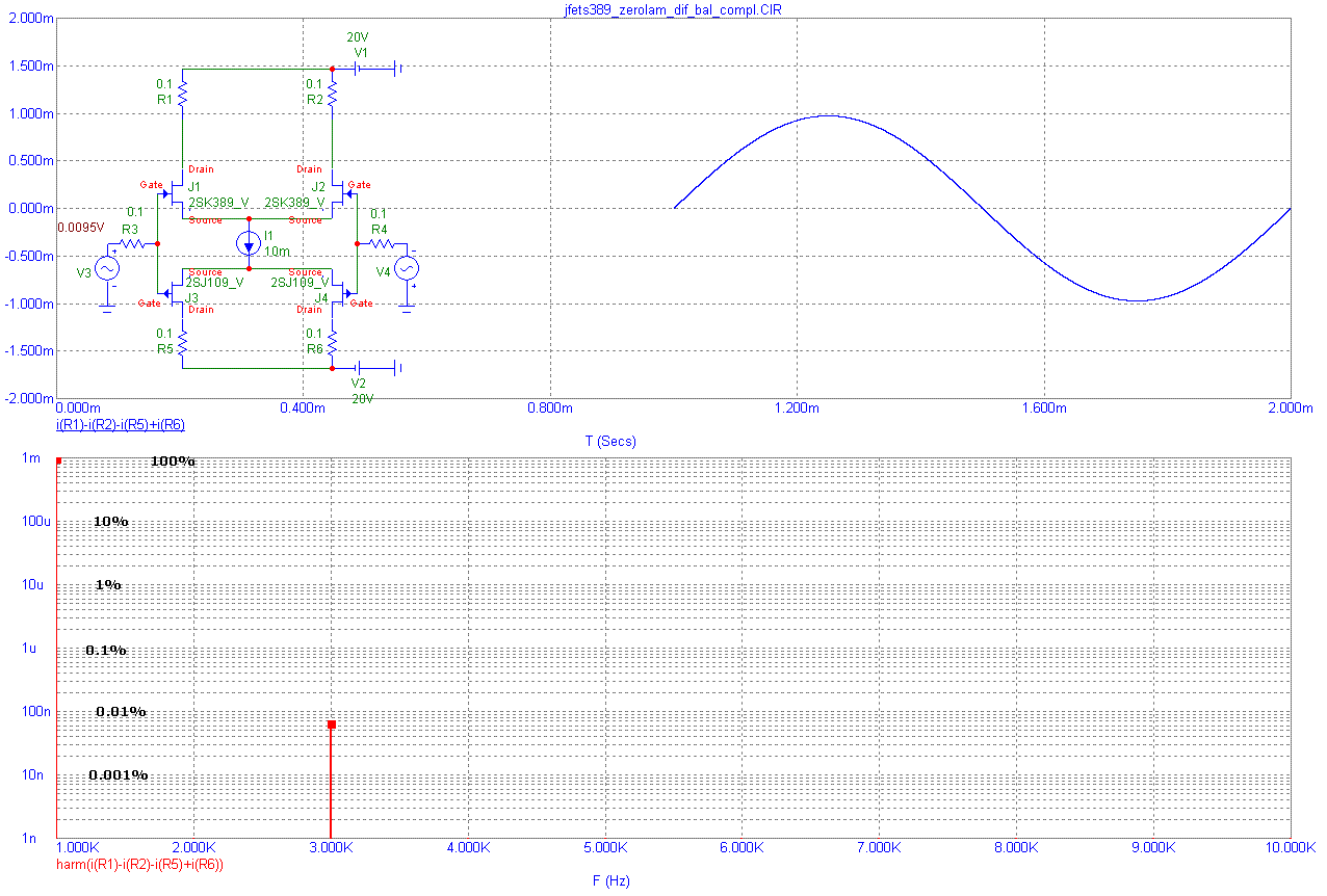

A serious question albeit perhaps "trivial", why symmetric stuff, the lowest harmonic coming out of symmetric is H3 (well, some H2 due to non-existing perfect complementary parts), while SE and alikes fundamental harmonic is always starting at the lower H2.

First point of contention -- why is that actually valuable? JFETs fine, plenty of merits there, but fully complementary is plenty contentious without much in terms of benefit for discrete. What's the justification?
How about a much more accessible first-class arrangement and starting with just n-jfets? The selection (shrinking rapidly) is infinitely better. Not like we cannot boost the input rails up high to get the common mode range we'd want.

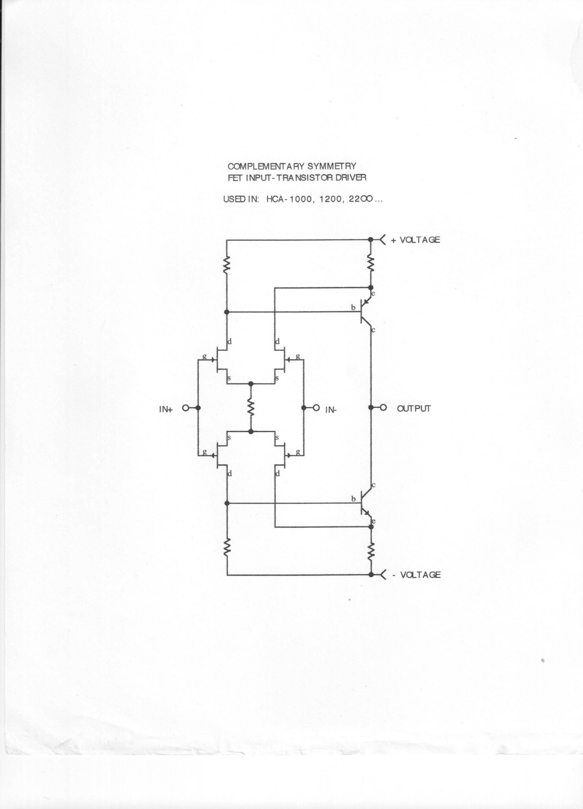

Now that the 'peanut gallery' has made their criticisms, I will go forward with MY VERSION of high quality audio electronic design.
First, I will have to describe the input stage that I tend to use, its advantages, trade-offs, etc. Now, this is not really a new input stage design, I have used it for the last 45 years, and finally it is now appearing in engineering textbooks, but it does have some advantages.
Now, I will have to search for visual aids to give further insight.
Don't forget to inform whom of the chinaBay vendors is you trusted jfet supplier so the happy diya community can realize it.
Here is my first practical implementation of this input stage to make a working line stage. It became a working module for the Grateful Dead 'Wall of Sound' electronics in 1963 and for the line stage of the Levinson JC-2 preamp at about the same time. This design works fairly well, is very fast, about 100V/us, and sounds subjectively very good. Better circuits can be made however.
Distorsion a little to high - should be below 0,003% in order to be inaudible acc to Mr Benchmark. But then you need to allow for other units to take part in the budget so why not aim for 0,001%. At the same time - please develop a measurement procedure that mimic music dynamics and richness - sine is so boring.
