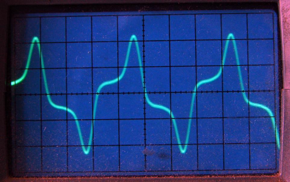

Waly’s writing is correct. So is Wavebour’s suggested practice. But you unnecessarily increase iron size this way.
For a given core volume, increasing the number of turns reduces the core flux without the penalty of more iron.
If all is arranged well (an art) the extra copper will reduce the empty window space too (good for voltage regulation).
Magnetization current goes down with increasing primary turns.
You can add some turns (same direction of rotation with the existing winding) on a transformer you have. Measure the primary current before and after and watch on an oscilloscope the waveform of the secondary winding.

George, Sure inductance goes up with n^2 (for linked flux), and increased inductance reduces current through it. But, IIRC flux or flux density goes up with n?

The primary current waveshape distortion is a good indicator of where is the operating point of the transformer
