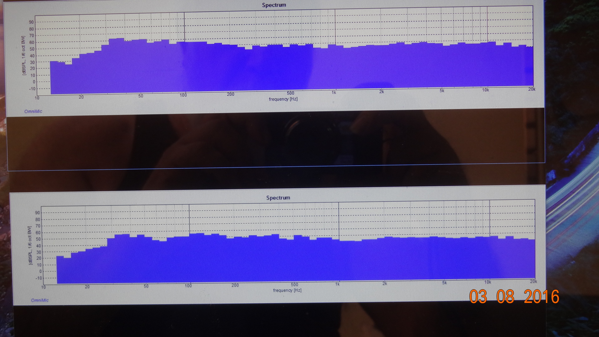

let me qualify that overly generalized statement.... I don't know which average size home we are talking about... American or European/Asian? Most speakers system used for home are wide dispersion designs. This reduces the critical listening distance and that distance is often not acceptable for most people --= who don't want their sofa only a few feet from the speakers. narrow dispersion can put that crit distance further away from the speakers. But how many home systems do you see which have narrow dispersion? Not many for sure. The panel type speakers can help. Other wise you have to use extensive room treatment and still not be as uncolored as near field. My living/listening room is large.... and I choose narrow dispersion speakers.... this places the crit distance further away. Together, I get a flat response at the listening position/near field even 10-12 feet away. Not messed up by room resonance/reflections, modes etc.
A flat freq response speaker - measured 1-3 feet away in echo free chamber is all messed up by the room..... unless you listen in near field and with narrow dispersion speakers. of course you can use typically wide dispersion speakers and spend a lot on room treatments.
With narrow dispersion -- minimum room influence results in same flat freq response at the listening position. No EQ was needed to get flat extended response. No extensive room treatment needed.
Freq Res at listening position using JBL M2; NO EQ used. Measured at 12 feet to sofa. :
THx-RNMarsh
