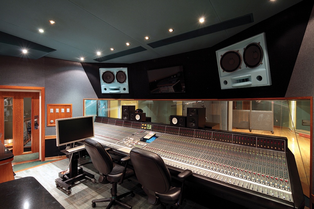

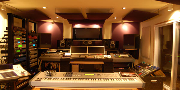

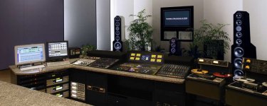

But also there is this point about recording vs mixing vs mastering. I have attached a couple of images of mastering suites and one of a very well known English recording studio. Mastering studios don't have NS-10s! So are you after the recording studio sound, or the mastering studio sound?
You will also notice that Bob Ludwig has put a LOT of effort into ensuring the reverberant field is correctly diffused! Would seem that 'listen nearfield' is an oversimplification unless I have missed something?

As ever Richard, your links pose more questions than they answer. As your link points out the critical distance has several variables, One of which is speaker directivity. You have changed from quads to M2s. This will have completely changed your critical distance. How did you change the listening position to account for this.

The first picture is a studio done right.... there are 2 near field monitors to use situated close and between the engineer. The second and third one is done wrong on several counts.... the speakers are behind the console and thus some direct sounds are reflected off the back of the console. And the multiple driver speakers are too close to become point sources.
The last picture tells me nothing about the studio or anything else.

The second picture is Bob Ludwig's mastering suite. A lot of good records have been mastered in there!
Doesn't matter... would you listen with speakers behind desk blocking direct sound. I hope not.

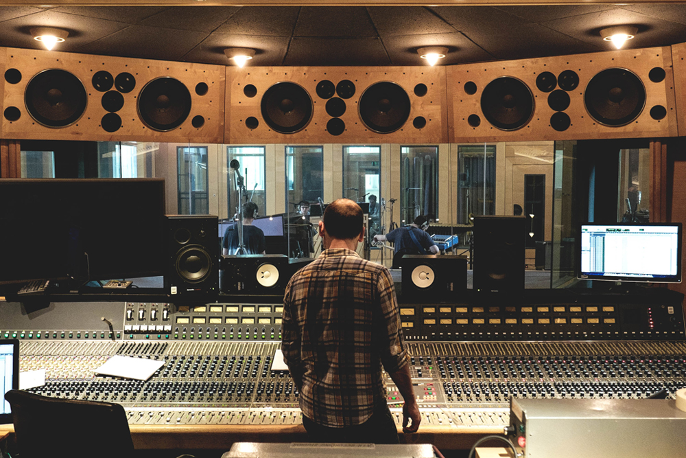

See for example (and comparison) the tremendous effort that went into the famous Massenburg room at Blackbird studios:
https://www.blackbirdstudio.com/studio-c/
Nah blackbird has glass tops on the equipment racks 😛
Like their monitors! But this brings to my point. Should we be aiming for the acoustics of the mixing studio when the proper monitors are being used OR the mastering which should be what is signed off by the band?
