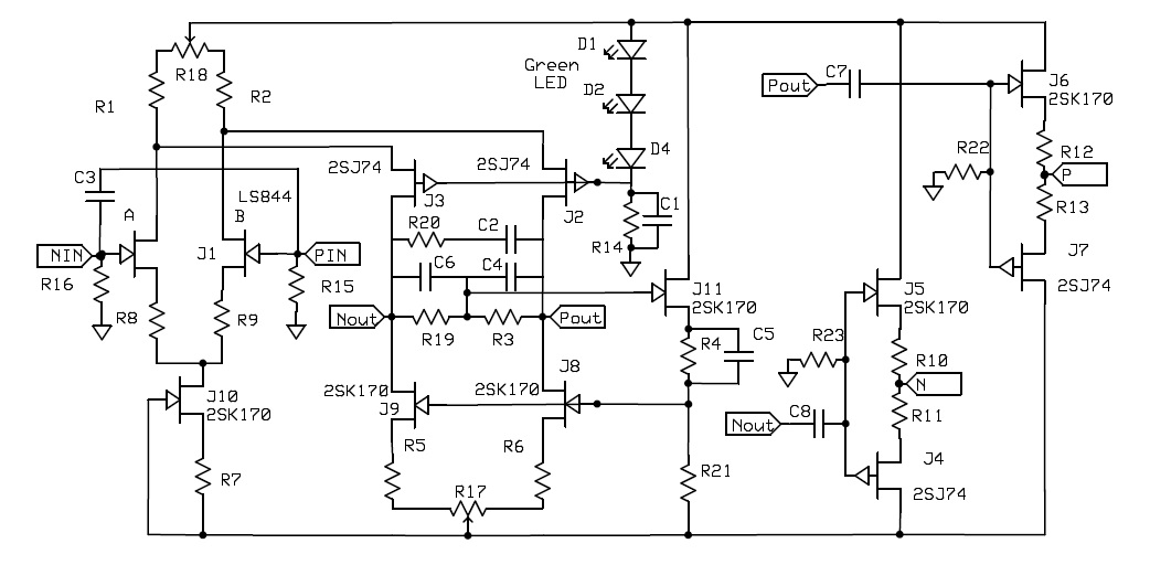

Here's my simple phono diff-in, diff-out, all FET no feedback, stage one passed - no oscillation. Need to solder in the 1% PP caps and try it. I figure this is as far away from op-amps as I could get. No need for comments this a curiosity project (I suspect I won't hear a difference).

May I add 2c? You put RIAA network R20,C2,C6,C4 between two differential nodes, each has huge impedance to ground. I played with such circuit in the past (with two AD844) and noticed that the common mode noise is high. You may use amplifier with good CMRR to suppress it, or you may consider to split your RIAA network in halves and reference common node to GND

Yes and yes.Thank you. I can see couple of inductors in each channel of MM stage, are you forming time constants with RL circuits? And your MC stage, was it inspired by Marshall Leach and LC audio light MC headamp?
No, J11 with the split RIAA cap is a tight loop controlling common-mode at AC as well as DC.
I went back to the sim the common mode impedance (with respect to noise gain) is about 1.4K with that common mode loop over the audio range. That does not contribute significant noise and the PSRR is better than you might think.
