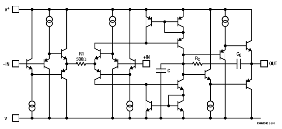

> I don't see what's so exceptional in it.
The symmetry of the circuit !
Quite beautiful .......

Lots of those around. I love the cap load drive crossover distortion enhancer (Rc,Cc) it shows up on the data sheet BTW and I can see that maybe it could get audible with a bad enough load.
BTW This "feature" was fixed in later parts IIRC as drawn Cc injects load dependent distortion directly into the gain node.
