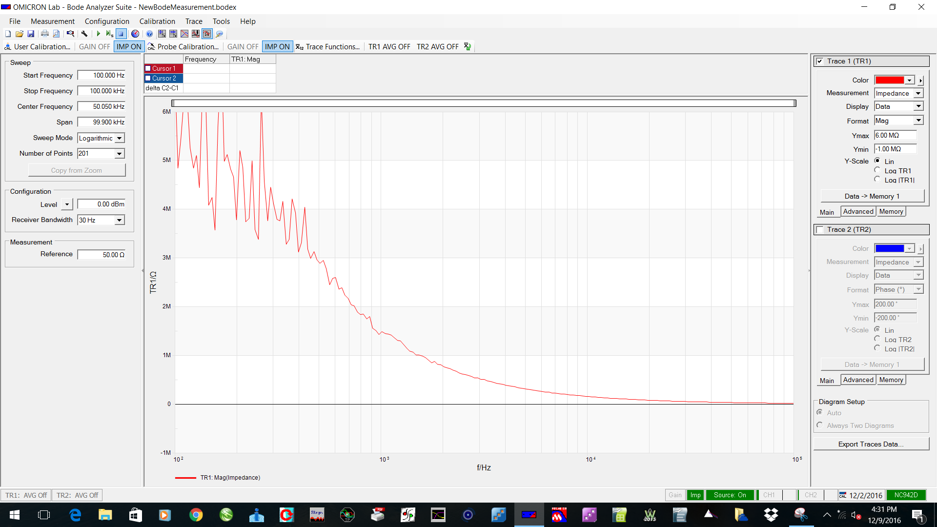

Can I inject something technical ;-) ?
Am trying to measure the input impedance of a BUF634 unity gain open loop buffer. Spec says 8meg (or 80meg, depending on bandwidth setting) // 8 pF.
Now this chip has no connection to ground, and has floating supplies bootstrapped from the output. So, how should I consider the 8pF? Model like 2 x 4 pF to each supply? If so, and the supplies are bootstrapped, would I measure no input capacitance?
The attached measurement belies that.
