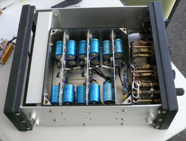

Inside of the Brookdeal 431. One would be tempted to think that three, at first sight identical, PC boards in a 60dB preamp would mean three boards of 20dB gain each.
But that's not optimal - for best S/N ratio we normally try to pack as much gain in the 1st stage as possible. So the plot thickens.
I like those big blue Philips electrolytics from the time I worked for them.
Probably all dried out by now, just like me 😛

The Brookdeal 431 also has a LP and HP switchable filter; an immediate use would be to make it less sensitive to mains hum.
Most of the transistors on the boards are 2N4126 which is not particularly low noise, and a BC184C which isn't either.
Now I'm really curious about the circuit!
Jan
Jan
Those were nice caps. I bought them for the color and compact size.
