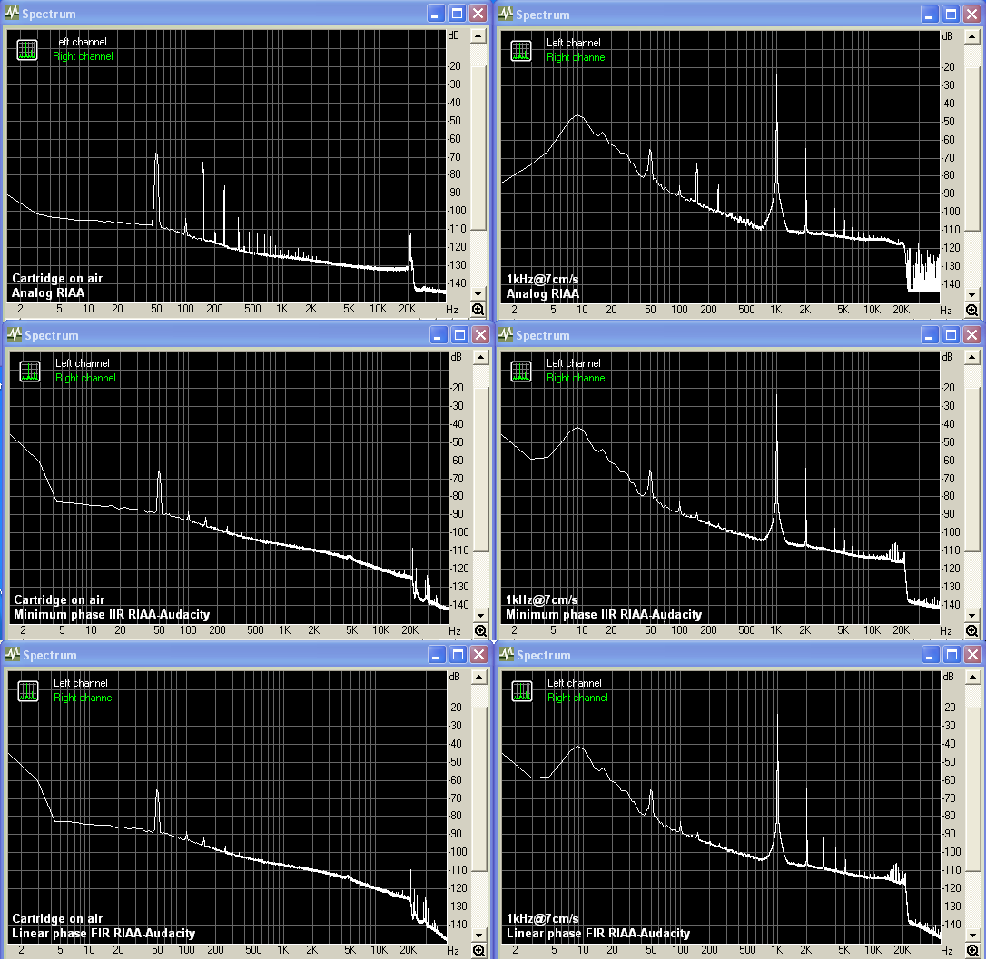

Thank you forr for your input.
In testing, noise level is different btn analog and digital RIAA.
It seems Audacity introduces some noise when equalizes (but not when amplifies, checked). See left column in attachment 1 (cartridge on air).
When cartridge is lowered and starts reading the groove (right column in attachment 1), this difference in noise is hidden by the surface noise of the vinyl, or at least this is what the FFTs shows and what my ears discern. With these recordings I’ve uploaded (*), I can’t hear any difference btn analog, FIR or IIR RIAA.

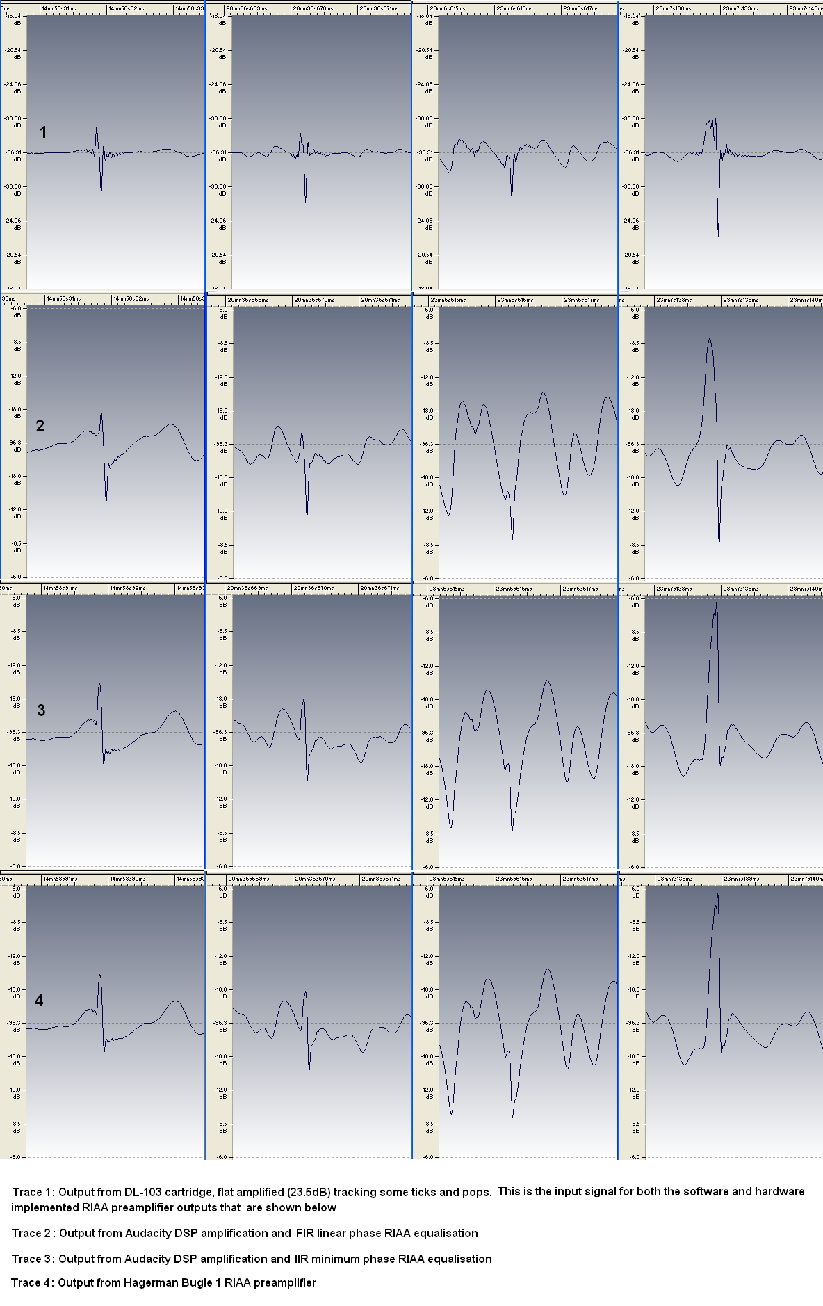

As I said, I can’t hear a difference and I would like to have your input (my hearing acuity is not good). But minimum and linear phase RIAA de-emphasis treat cracks and pops a bit differently, see attachment 3

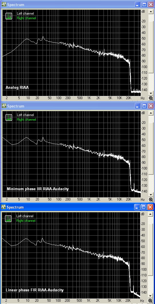

(*) It’s side 1 of the record you see in attachment 2, a typical case (content and condition) of the vinyl records I am interested in ripping.

The FIR is different, isn't it?
The screenshots of clicks and pops are different.
Sweep frequency response vinyl track shows no difference 20Hz-20kHz, see attachment.
