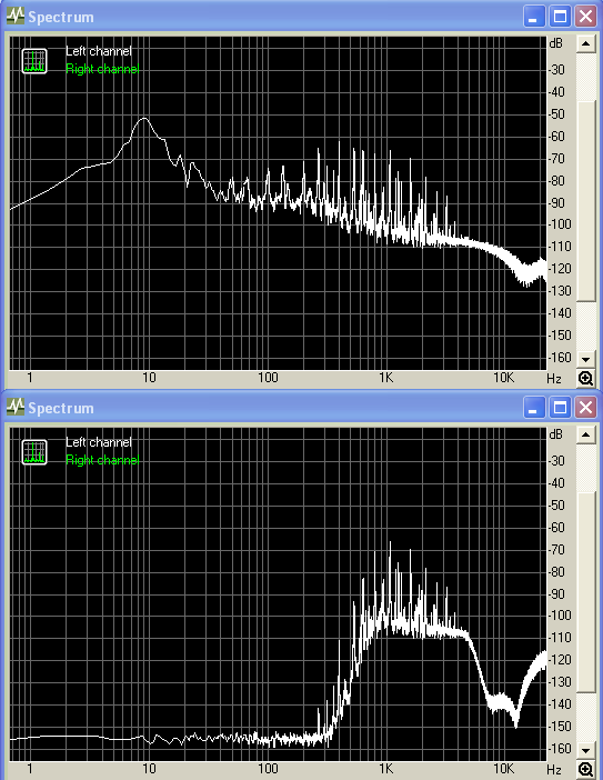

(*) Your slice is from the analog RIAA, starting at 38s exact and ending at 47s. You’ve introduced a generous fade-in. What filter did you use for the filtered version? FFT shows something like a 36dB/oct BP at 700 @5k)

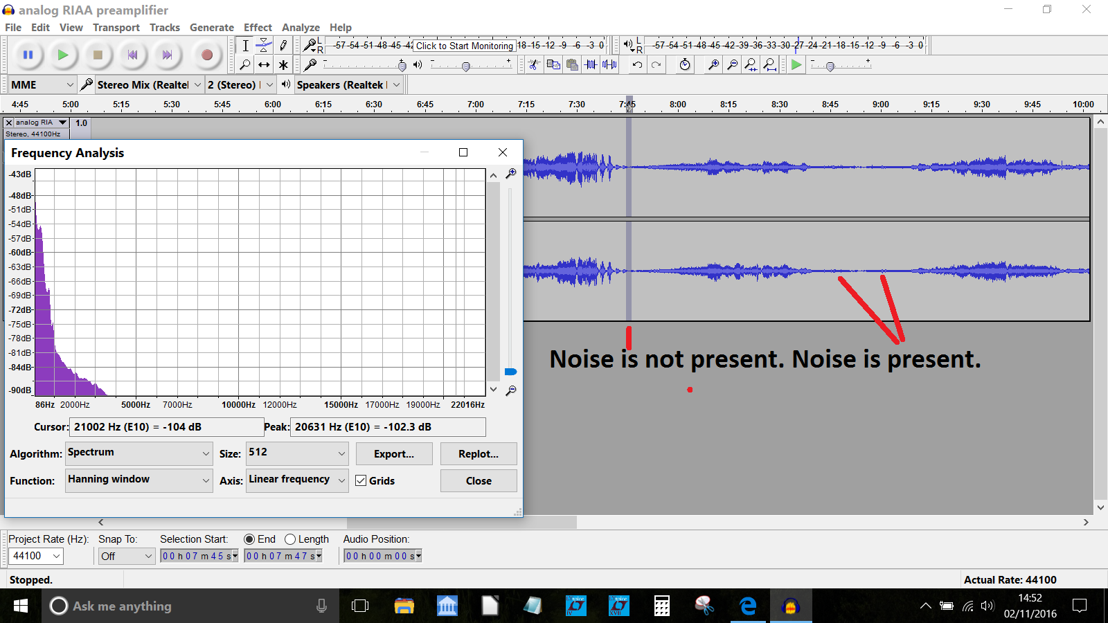

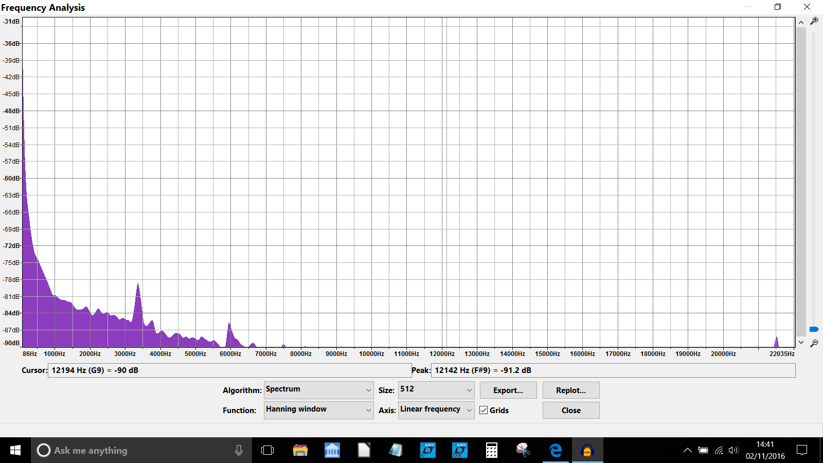

I'm going to try and pin this down a little more if I can. Its definitely not ambient/venue noise. Its present on all three versions and sounds a little like a digital watch alarm but with unequal and varying 'beeps'. Very odd ! I listened firstly via my main amp and speakers at a very modest level and that's where I picked it up. File was on flash drive plugged into my Marantz SA-CD player. I can hear the same thing listening with headphones on the PC.

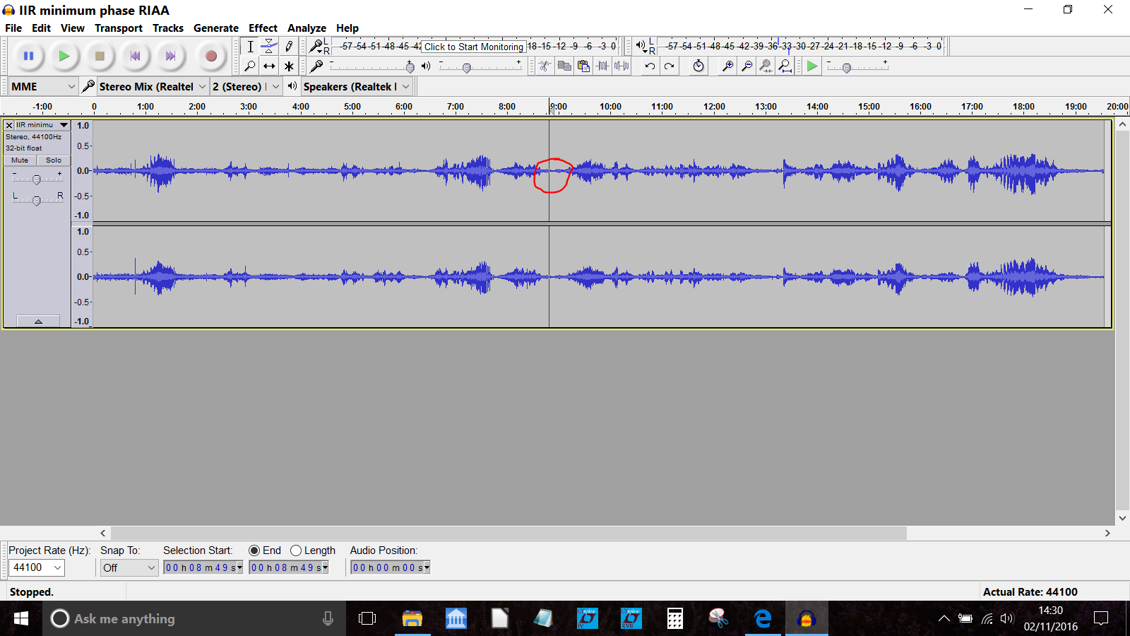

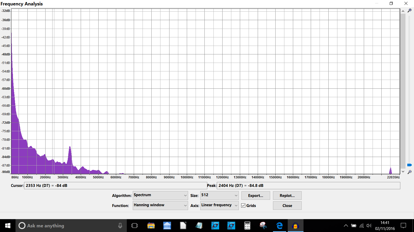

This is from around 8' 50" in. High bitrate MP3 file this time but the beep is very audible.
About halfway through this sample there is a faint percussive sound in the right channel. The beeping is as prominent as that.
This time I used the IIR minimum phase as the sample material.
I used the high and low pass filters in Audacity but didn't make a note of the settings. Just playing about really.

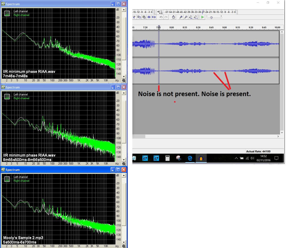

What I know is that with only a lot of attention I managed to isolate with FFT what you claim that bothers you.
Man, it’s at –90db!
It’s 10dB above the local noise floor, while the max in this recording is at –14dB (and the average at –27).
Needless to say, I can’t hear it. That’s for sure. I tried for two hours. My tinnitus whistling must be some 40dB above it.
Sad to admit it, but I've never heard the 'kingsway rumble' on a recording.
Bill, that ‘Kingsway rumble’ must be that 40-50Hz bump present in the FFTs (the 50Hz spike in my set-up is 15-20dB below that bump and it is centered at 50Hz).

I'm not sure what to say tbh :) My listening room is pretty quiet, an SPL meter (C weighted) is currently hovering between 21 and 25dbc. Listening levels are peaking at around 70 dbc just now (opening of Chopin scherzo No 1 in B minor as I listen for Bills rumble as Ashkenazy tinkles the ivories).
I don't know what to say regarding the beeping tone, although its not loud in absolute terms it is very noticeable at these kind of very modest volume settings.
