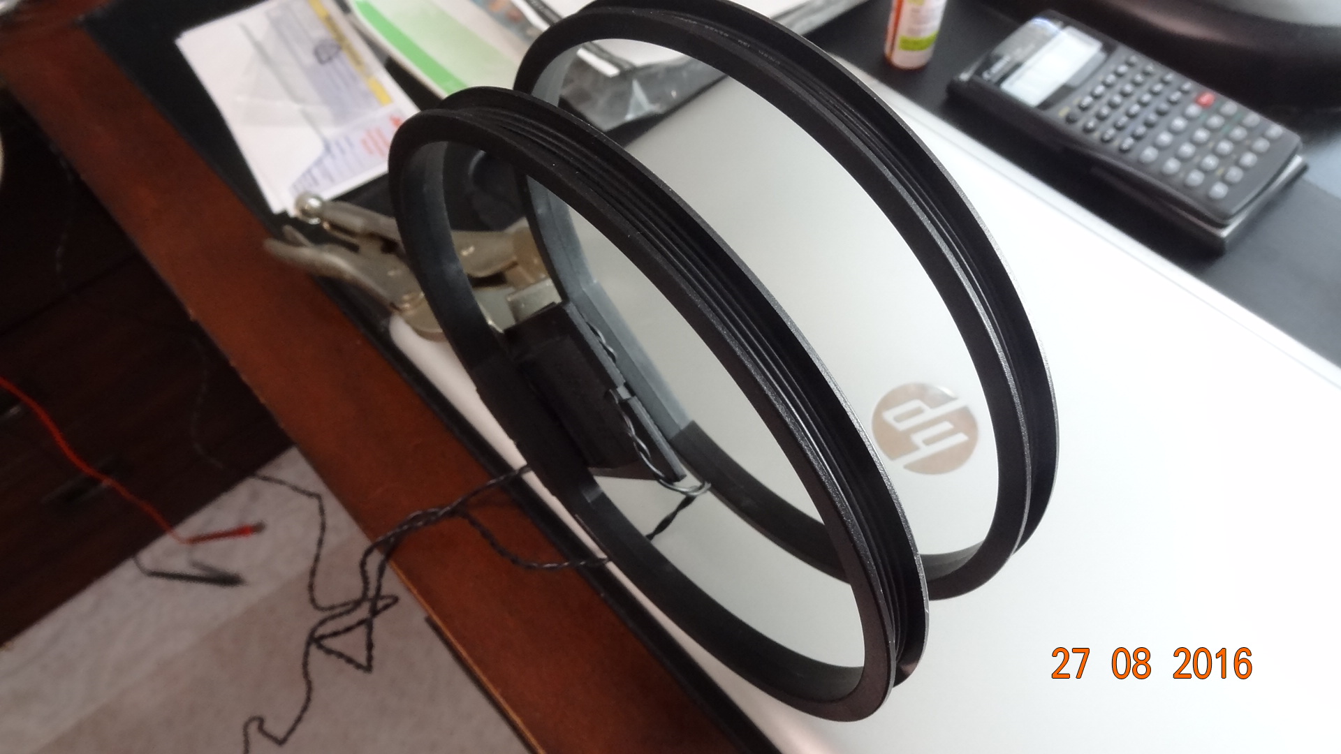

Skin Effect T&M
FYI
Using a test and measurement for skin effect (caused by eddy currents) sent to me by Davada over here, I did a skin affect test to determine the freq it becomes a player -- 🙂
I said 8Khz. Other say >100KHz et al. So here is what I got from this setup:
Using 1mil of copper thickness (placed between the xmt and recv coils) =
-1dB at 4.5KHz and -3dB at 12Khz.
Using a double sided pcb (FR4) of 1mil copper =
-1dB at 1KHz
-4.5dB at 4.5KHz
-6dB at 8.0KHz
-9dB at 12KHz.
Using two such pcb back to back = -9dB at 8KHz.
Aluminum was spot checked and so was steel plate (from a chassis cover). Obviously, the steel came in at very low freq and at high atten./loss.

Is the test sample smaller than the coils?
Okay. But in the early days of multi-track digital recording, people tried using multiple sound cards at once for recording. Over the course of a song, 2-3 minutes, they found that by the end of the song the tracks were out of time with each other and the recording was therefore unusable.
Yes I understand I think we're talking about two different things. Two 10 MHz frequency references that have a slow wander from each other and eventually get un-synced is different from a .6% by design error.
Two plays of the same LP superimposed is a fun revelation.
About the same size... 95%. Some >100%
Only one was 65%.... first one listed.
Alum foil (100% of coil size).... -3dB at 12KHz

What is it without a plate. You have to account for the inductance of the coils.
I normalize to zero ref level at each freq. Then insert metal between coils and read atten dB's.

I can't figure out how you are using that test set-up. Do you place the test materiel between the coils?
A setup like that is sometimes used to check for cracks in metal samples, in which case a crack would change the normal eddy current effects. If you google "Non-Destructive Techniques Based on Eddy Current Testing" it finds a document with that name. The setup is shown in Figure 24, on page 2552. It's not clear to me how one could interpret the results of that test in terms of audio cable performance. It would seem easier and more direct to measure some actual speaker cable for differences in AC and DC resistive losses at various frequencies. Maybe I am missing something.

That is not a test of skin effect per se. It is a measure of eddy current based flux exclusion. If you go to my gallery, you will find measurements showing inductance of coils in air as well as against copper clad.
You are seeing the loss of coupling because the metals are fighting the rate of change of magnetic field. It is NOT consistent with the coil wire diameter, nor is it consistent with any interconnect wire used in audio.
It is consistent with a conductor of the diameter of your occluding metal.
The plots in my gallery show several things. First, the increase of resistance caused by proximity effect losses within the conductor; it increases without bound. Second, it shows the inductance falloff as the current centroid shifts due to proximity; it is bounded as it cannot leave the conductor.
I am not able to view the test setup from where I am, so look forward to seeing it. It may be better poised to view the non linear mixing of two signals when one modulates the permeability of a steel enclosure using the wall as isolation between noisy currents and low level signals.
That said, your setup is not exposing skin effect on wires, so you cannot claim that 8 kHz threshold, as you are not measuring skinning per se.
Nice test though.
