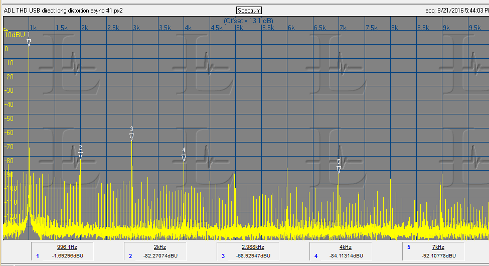

The plot is a particularly poor USB headphone amp that probably has a cult following.

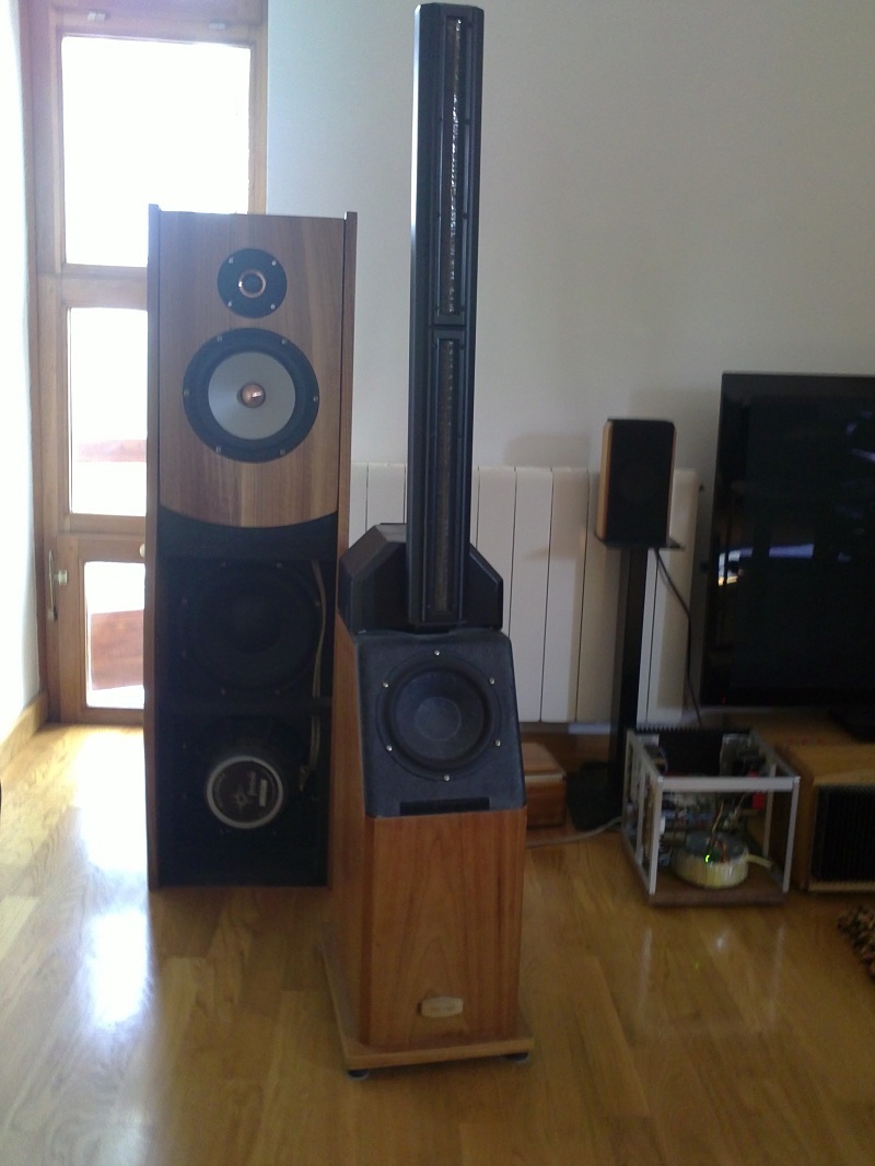

In my time I've designed some loudspeakers. I was reading a lot about Linkwitz loudspeaker design. What I have found that its quite important to have similar horizontal (actually toward a listener) dispersion around crossover frequency.
In one of my design I used Scan Speak 18W-8545k0 midwoofer and Newform Research R30 ribbon twitter. The crossover frequency was 1 kHz. To get similar sound dispersion around the crossover point I angled the woofer by about 30 degree, look the photo, I like that loudspeaker alot(behind is Orion from Linkwitz)
By the way what do you think about open baffle concept prefered by Linkwitz?
