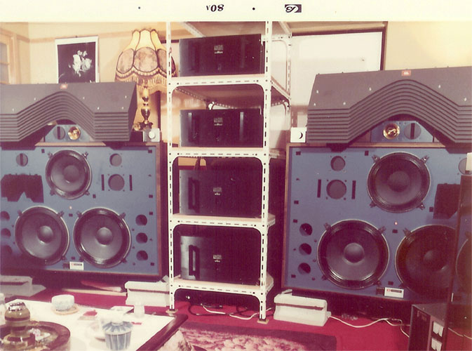

I use 4 of the 1970's JBL yard wide 2395 lens with 2441 Alnicos in our 4 way shop PA - rather like these in black plywood with twin 18s in each
4 of them do 3000sq feet quite well
