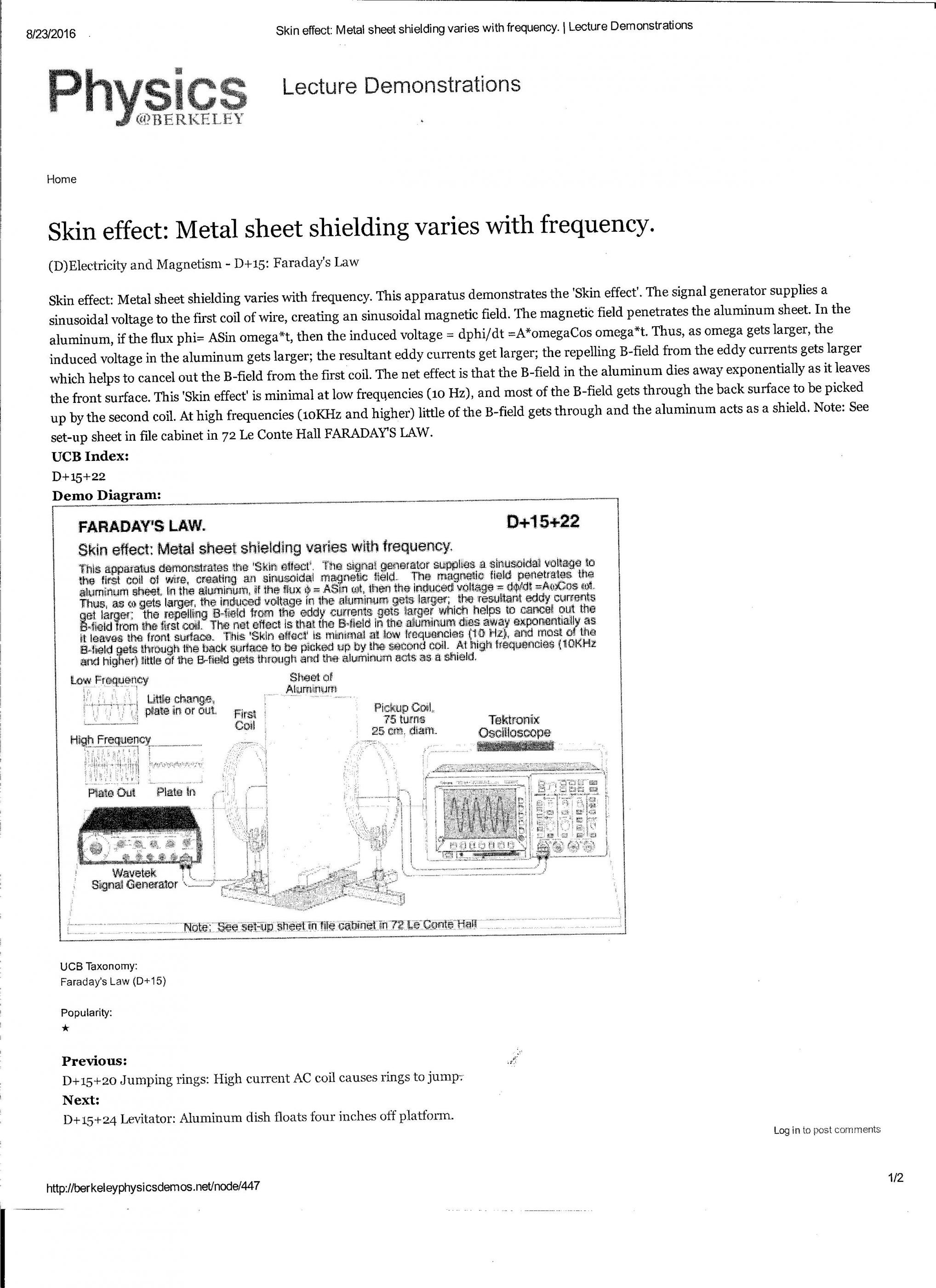

That is not a test of skin effect per se. It is a measure of eddy current based flux exclusion.
I am not able to view the test setup from where I am, so look forward to seeing it. It may be better poised to view the non linear mixing of two signals when one modulates the permeability of a steel enclosure using the wall as isolation between noisy currents and low level signals.
That said, your setup is not exposing skin effect on wires, so you cannot claim that 8 kHz threshold, as you are not measuring skinning per se.
Nice test though.
John
Yes, I was aware that it might not be a direct measurement of skin effect. However, this is where skin effect would start to show itself as the source paper indicates.
There is really nothing to show... an osc into an amp driving a coil. A sensitive voltmeter is connected to the other (receiving) coil. Metal is placed between coils.
It is also useful to indicate relative shielding effectiveness of various metals and thicknesses. vs freq.
THx-RNMarsh
Source---
Thanks.
What needs clarity is definitions.
Skin effect in a wire discussion is detailing the exclusion of current from the center of the wire as a consequence of faraday's law of induction, as caused by the current within the conductor.
Skin effect in a surface discussion is eddy currents generating magnetic fields in direct opposition to time varying magnetic flux trying to penetrate the surface from an external source. This is what your measurement is doing.
My inductance measurement of coils in air and against copper demonstrate the way copper will exclude dB/dt by eddies, which lowers the total energy stored in the magnetic field. My test also shows how the meter reads the eddy losses only as Rs.
My inductor sweeps show the inductance breakpoint at 10 kHz in air, this due to proximity effect. It shows also the break at 1 kHz when the clad copper is against it. Neither should be attributed as "skin effect" per se as that tends to reinforce misunderstandings that skin effect plays a huge role at audio frequencies in single or paired conductors. Since magnetic energy storage (inductance) goes as the square of turns in a coil, even a coil with 100 turns can show proximity (skin) losses that are measurable as the enhancement over a single conductor is four orders of magnitude.
As a shielding test, it's great.
John

Thanks.
Yes, it might have that effect on some readers. But we know it is rather minor and not first order atten cause. OTOH, high-end would possibly consider it and try to minimize it also.
It does come into affect in the audio range of freqs. which is what i wanted to know/establish.
Next, I want to know its phase shift and how it (Skin signal) can effect signal integrity compared with lower freqs in typical audio apps... pcb, wire, cable. Such might occure in music fund vs harmonics.
THx-RNMarsh
