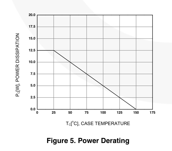

But the derating is given for case temperature, not junction temperature.
se
Steve, I looked at some of those data sheets to find out at which point the 'case' was defined, but I cannot find it.
In my understanding, case temp is defined at the metal back that is in contact with the heatsink. You mentioned that it would be the plastic top of the case.
This is important for me so if you could point me to where this is mentioned, would be nice.

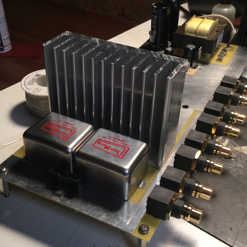

Just give it a big heatsink, problem solved....you are obsessing like Henrylrjr on another thread.
It already has a big heatsink (relative to the power it has to dissipate). It works just fine at typical room temperatures. I just want to verify that the case temperature will stay at or below 100°C in the event that some idiot leaves it turned on and leaves the house on some hot summer day with no cooling and the ambient temperature in the house hits 50°C.
I'm going to fire it up in a 50°C ambient temperature and would just like to monitor the case temperature to a reasonable degree of accuracy so that I can turn it off if the case temperature starts to go over 100°C. I only have two pre-production circuit boards and want to produce two pre-production amplifiers so I don't want to risk destroying one of the circuit boards if the output devices go over temp and fail.
You get it now?

I pulled up the datasheet on the fairchild bd139 from a googled alldata hit.
I see nothing to indicate that it's an isolated package. If it is, it impacts the derating curve.
The datasheet I found has Tc, or case temperature. For all practical purposes, that may as well be considered the heat-sink temperature, especially for the size you show and the thermal flux you'll be pushing. It should be within about 5 degrees of the backside of the case.
I am not confident a top of case measurement will be consistent with the datasheet. Nor, that it will represent the junction temp.

Says "Case Temp" on the axis label....
Exactly.
The data sheet specifies a maximum junction temp of 150°C, but the derating curve is for case temp, and the ST data sheet give a delta T between junction and case of 10°C/W. In the current setup, each device is having to dissipate just under 4 watts, and from the derating curve, case temp can be just a bit over 100°C, but I'm setting the limit right at 100°C.
