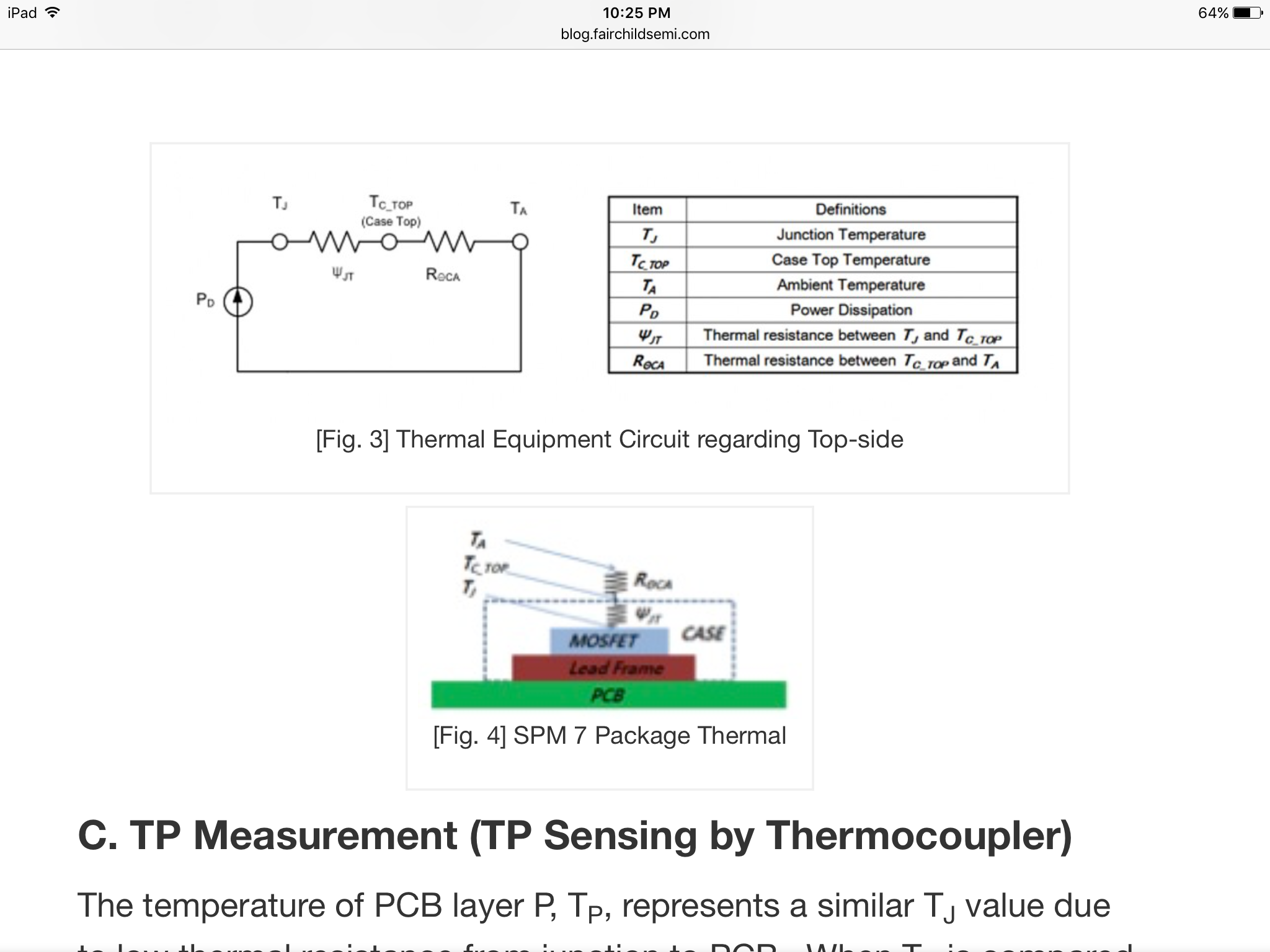

I think for the purpose of thermal ratings "case temp" really means the external temp of the metal heat sink interface the die is bonded to
Ok, this would seem to indicate that the case is indeed the molded plastic portion. What you seem to be referring to is the lead frame.

Thermal resistance from junction to case of a BD139 is 10C/W
Derating factor is the reciproke value, 1/Rth(j-c) = 0.1W/C
Max dissipation is when the case temperature is at 25C, and the die at 150C.
150-25=125C
Rth(j-c) times 12.5W (Pd) = 125C
Zero dissipation is when both the case temperature and die are at 150C
150 -150 = 0
Rth(j-c) times 0W = 0C
Aka, the temperature in the derating curve is the one of the case
(semiconductor-thermo 101)
