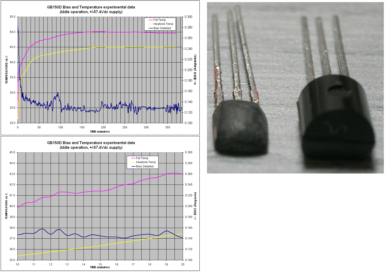

[a relic would use a $1 temperature sensor in a TO92 package, LMx35 series]
surviving in the pockemon go era
(LM335 hand file down encapsulation. Cut leads very short, use very thin connecting wires, all for reducing thermal inertia)
