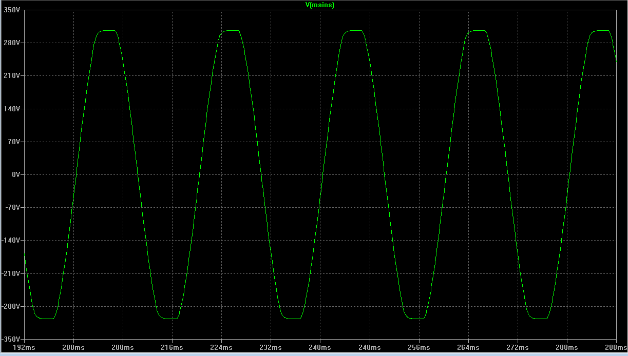

Better. Much better. The area under the current waveform (Q = integral of I*dt) remains the same, but the peaks become shorter and wider, which reduces the higher harmonics. Thus the equipment spews less HF garbage back into the mains, and whatever induction current loops exist within the chassis, radiate less HF garbage into unwanted "victim" circuits.
I'll have to sim that as it's non-obvious on inspection.
The attached .wav file (inside a zip archive) may help. It's a 230V, 50Hz sinewave with flattened top. Amplitude adjusted so VRMS is still 230V. LTSPICE total harmonic distortion (@ 1usec transient stepsize) is 5%.
To use it, you include a spice directive
  • Vname node+ node- wavefile=FILENAME.wav
and then gain it up to full amplitude, since stored .wav files are assumed to have amplitude plus/minus 1V.

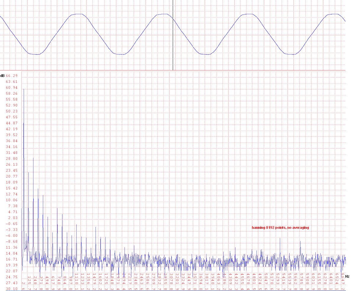

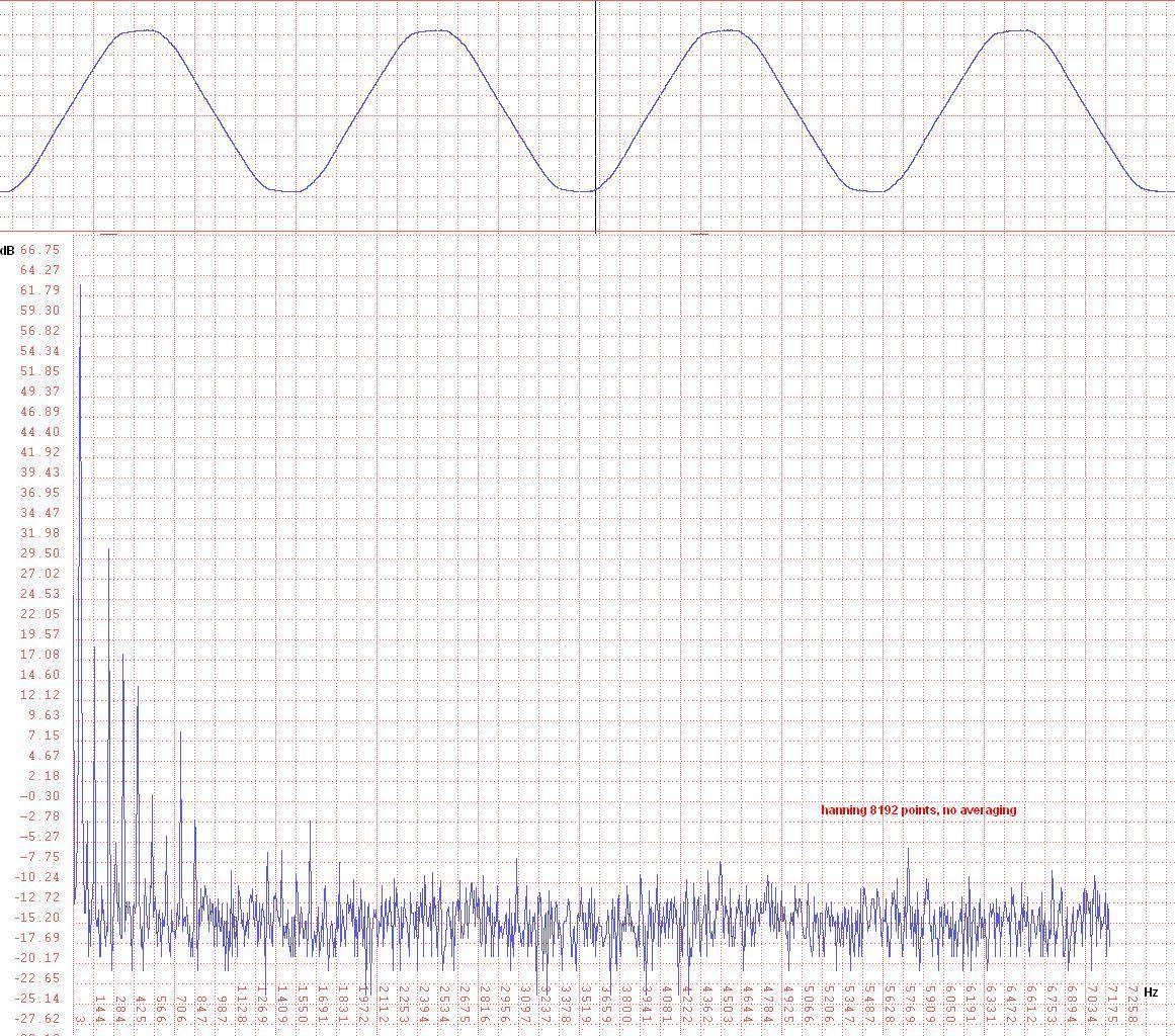

First attachment, 230V /50Hz wall outlet. Waveform with typical (in my area) flat top.
Second attachment, unloaded secondary of a 500VA isolation transformer connected to the same outlet at the same time.
Every transformer I have checked adds some more flat toping (noticed by increased number of harmonic peaks).

seems that your ac utility compnay allows heavy loading of their transformers.....keeps costs down, I suppose. In my location we have a power transformer for every 3 homes.... never see flat topped waveform.

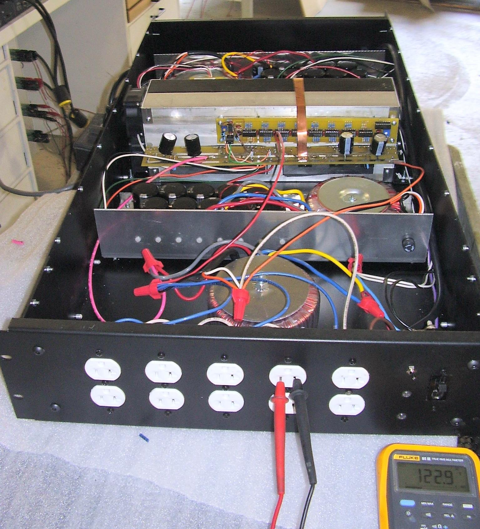

Elgar was building high power conditioners in the early 1970s. They had transformers and fans but were reall robust and .1% distortion at a full 15A rms load.
However that meant serious current harmonics which radiate more.
There is no magic that a sinewave has for a rectified load. The load pulls power at the 3rd 5th and 7th harmonics not the fundametal. Create a source with those harmonics and the power transfer will be cleaner and less switching noise.
I have done this with great success. Just expensive.
