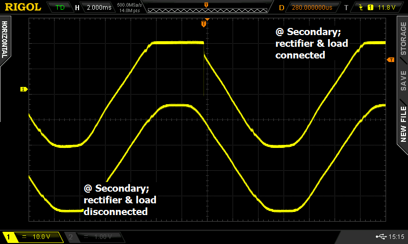

Here's the mains waveform at my house (bottom trace). Not quite a sine wave. If you view the image at 100% and squint real hard at the upper trace, you can see that the diode-induced ringing amplitude is bigger than the secondary voltage (!). This is a particularly not-excellent diode.
