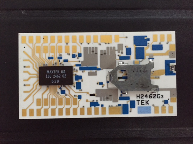

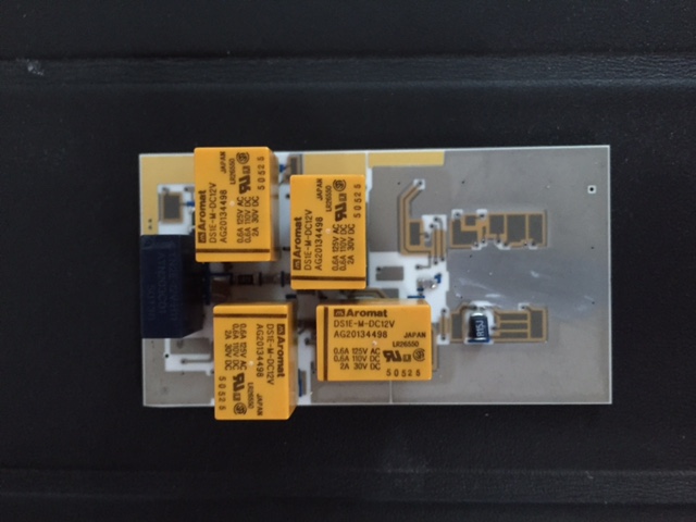

Not glass but ceramic: the TDS series Tektronix oscilloscopes attenuators and input stage circuitry. Double sided, thin film deposited resistor (laser adjusted) vias, gold traces, one IC, shortly a piece of jewelry.
Standard hybrid stuff. I was involved in that back in '83. I assume that's alumina.
Most of the stuff I worked with was that ceramic substrate soldered or epoxied into a hermetic case with wirebonds to the package pins. Did some SIP units as well, but not much.
