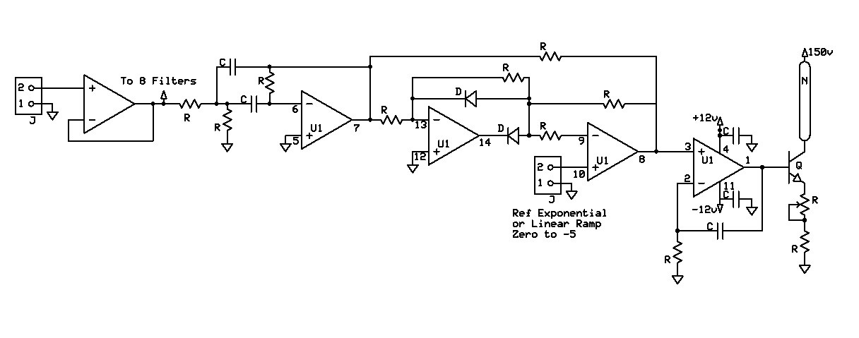

Well I got my desk cleaned today so a bit of play.
I am looking at building a 1/3 octave display using nixie style bar graphs. These go up and down depending on the drive current. So a variable voltage into a transistor base with an emitter resistor should do as a current converter. calibration is adjusting that resistor value. This is driven by a low pass filtered comparator that is feed with the DC value of the filtered signal after rectification and either a linear ramp voltage or a nice exponential ramp for a dB style readout.
Basic schematic is attached.
Something like that?
Audio Vu meter with IN13 or IN9 Russian nixie bargraph tubes
