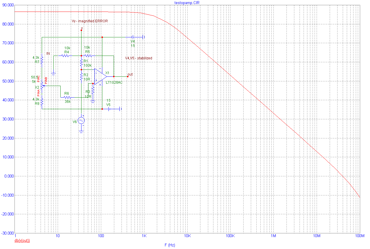

I think that low input current track might be correct. In the past years I tested many opamps in this circuit and one of badly behaving was OPA209.
I hunted down an old-dog programmable op amp, the LM4250, that has externally set input stage and other-stage currents. But it is very limited in that range and has 10k emitter resistors. It looks as if it would be truly horrible for audio use, but might be useful in researching the rectification issue.
Noise gain is 10000 or 80dB.
What about the 6 dB voltage divider in series with the 80 dB divider?
No, arny, Pavel, your line of reasoning does not seem to be correct.
You would be if the voltage divider were connected to ground in the non-inverting situation, like the schematic as shown in the OPA134 specsheet. In that case, gain and thus also noise gain is 6dB.
You can't just translate the table in this specsheet into the calculation of the noise gain in the inverting configuration. Because, in the non-inverting setup, the gain is 1, and thus noise gain in dB is 0.
Look at it this way. At the node in the voltage divider connected to the inverting input, the full amount feedback is available. The subsequent voltage divider between the 100k and 10 Ohm limits this by a factor of 10.000 or 80 dB.

I am tending back to my hypothesis that with the shunt network Pavel has, a very large portion of the feedback is shunted to ground to the point that there is not enough signal feedback current, so the device in effect operates OL, or partially OL for a portion of the input signal.
The JFET opamps don't have this problem since the required signal feedback currents are orders of magnitude below the bipolar opamps.
However, this does not explain the AD797 and the fact that it does not appear display this phenomena. It might be that the Ib cancellation scheme may have something to do with it.
For clarification ....
P.S.: still a plenty of FB left for high Aol devices like AD797, LM4562, LT1028 ...

I place my bets on the test jig implementation. Again, bipolar opamps with very low input bias currents are much prone to collect, perhaps rectify, and certainly amplify mains harmonics through magnetic induction in the test jig circuit loop(s).
Of course, the wealth of mains harmonics in PMAs spectra could be due to rectification in the input circuit (and would explain why jfet opamps don't look so bad) but having the input bias current as a variable, the current test jig implementation precludes comparing bipolar opamps.
I would consider a 4 layer PCB with 2 ground planes, with SMD parts and triple shielded against electric and magnetic fields a minimum, and a test protocol per the TI document, to be able to e.g. compare the LM4562 design to the LT1028 design "EMI sensitivity".
So far, the only conclusions that I see as valid are:
1. Jfet opamps are less sensitive to "EMI rectification" (we already knew that, isn't it?)
2. Bipolar opamps with low Ibias (call them "precision") are more "EMI sensitive" (makes sense, but is this a good enough reason to avoid them?)
I don't see so far any valid proof that (e.g.) the LM4562 is intrinsically (that is, by design) more prone to "EMI rectification" or more "EMI sensitive" than the AD797 or the LT1028.
P.S. To add insult to injury, "EMI sensitivity" and "EMI rectification" above are in fact, so far, ill defined concepts. A precise metric is required at least for the "EMI sensitivity" for an apple to apple comparison. Again, the TI document quoted above addresses this.

Input bias current sees 10 Ohm to ground. Shouldn't be much of a problem :cool:
That's on the schematic, not in the test jig implementation, the HF impedance could be significantly larger. Not to mention there's more than one possible loop where the EMI could be randomly be injected.
As a rule, if waving your hand over the circuit (as already mentioned by Mr. PMA) changes the output, then you have a test jig implementation problem.
What I'm still trying (apparently unsuccessful) to convey is that the differences recorded between the LM4562 and the AD757, LT1078, etc... are not necessary because of internal design differences, but because of the lower input bias current of the TI part.
You are right, 86dB. But it does not change the core of the problem.
I agree that it does not change the experiment significantly. 80 dB gain, 86 dB gain, whatever.

This proves that you are unfamiliar with the well known fact that a voltage mode signal source is properly considered a short circuit to ground all frequencies.
Engineering 221. Not exactly a rookie mistake but your inability to recognize and react properly to a clear presentation of correct technology is noted.
To me, your first sentence is completely nonsensical, whereas the post this triggered was very much about explaining what we are looking at. If you don't agree with my explanation, why not post technical arguments?
Anyways, Pavel, can you chip in? Or Scott? I just want to know if it is 80 or 86 dB noise gain, because if it is not 80, I have to improve my understanding. That is called learning, and I am not affraid of it. Unfortunately, I have not yet mastered the art of gaining understanding by means of insult.
