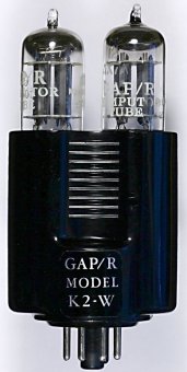

Do you have an opinion on the question of whether or not a modern equal to the Telefunken metal work of that era is possible? Some folks say that the world just gets better and better (as long as you live in the First World, anyway), and other folks say that specialized proprietary technologies can be lost and impossibly expensive to recover.
Lots of smart people in China, and some infrastructure - could the Telefunken 12AX7 be built today? A side note: McIntosh model Mc240 amplifiers ran these at 430 volts anode to cathode and I've seen lots of original examples still measure just fine, these many, many decades later.

There are probably a number of technologies that have been lost. A specific and important one is the metallurgy for the ultrastable resistors. The alloy and process for making it apparently have been lost so the existing supply is all there is. I gather the issue is that the guys who figured it out retired/died and the details were lost. It seems this happens with low priority products regardless of their real importance.
