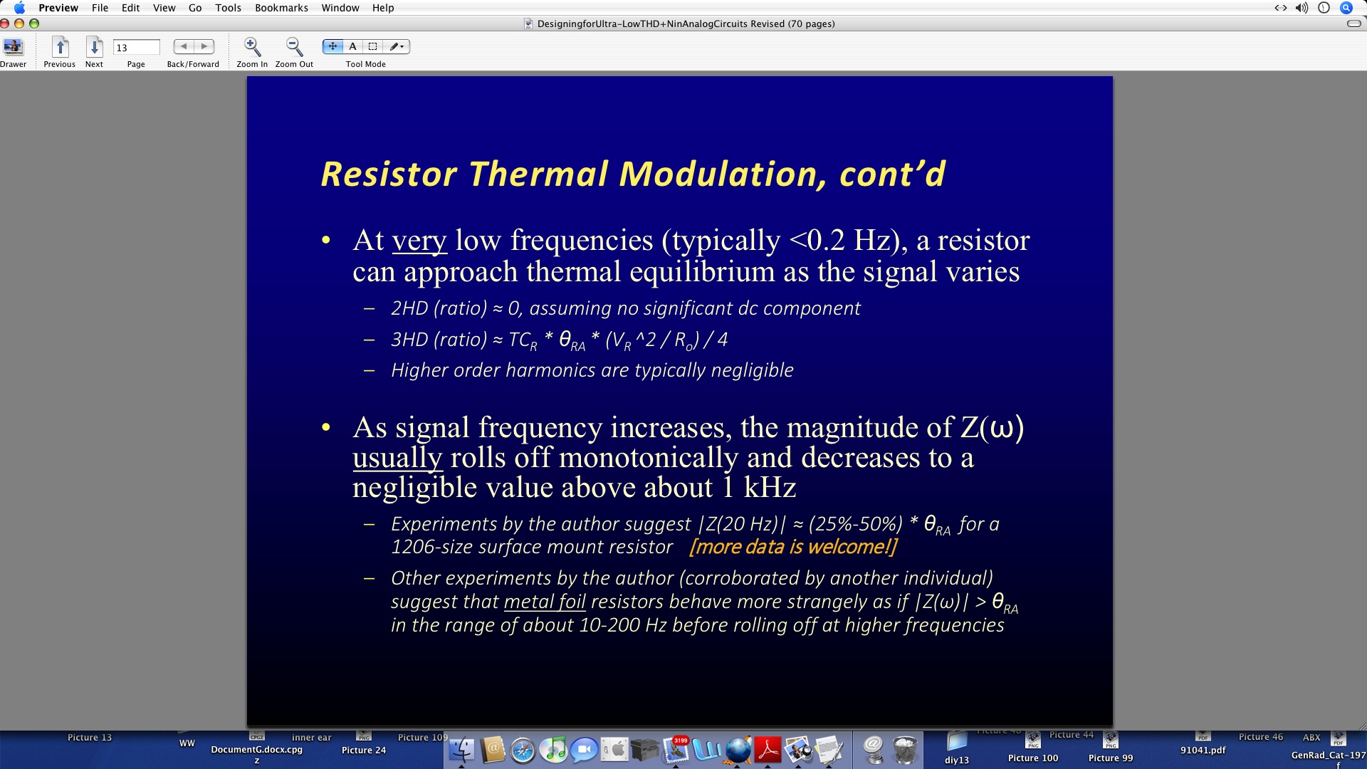

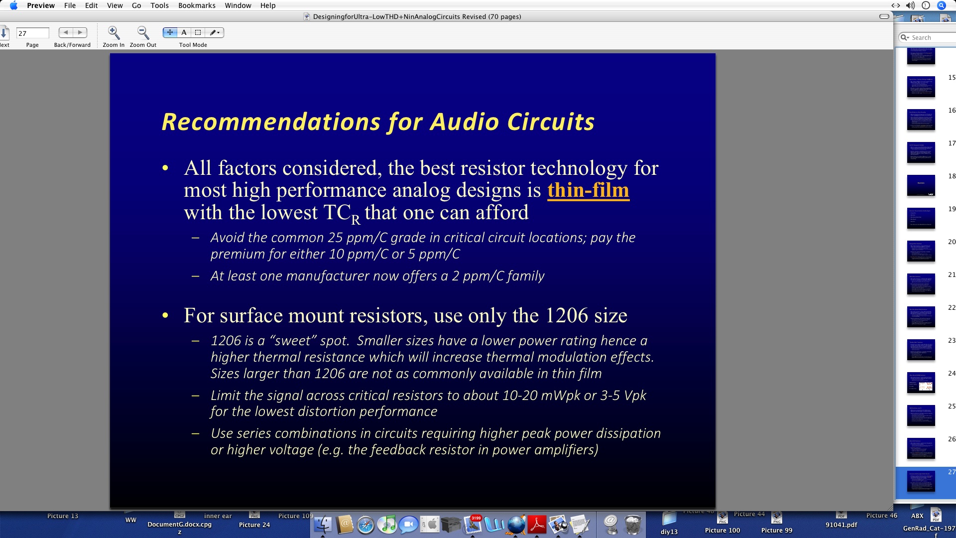

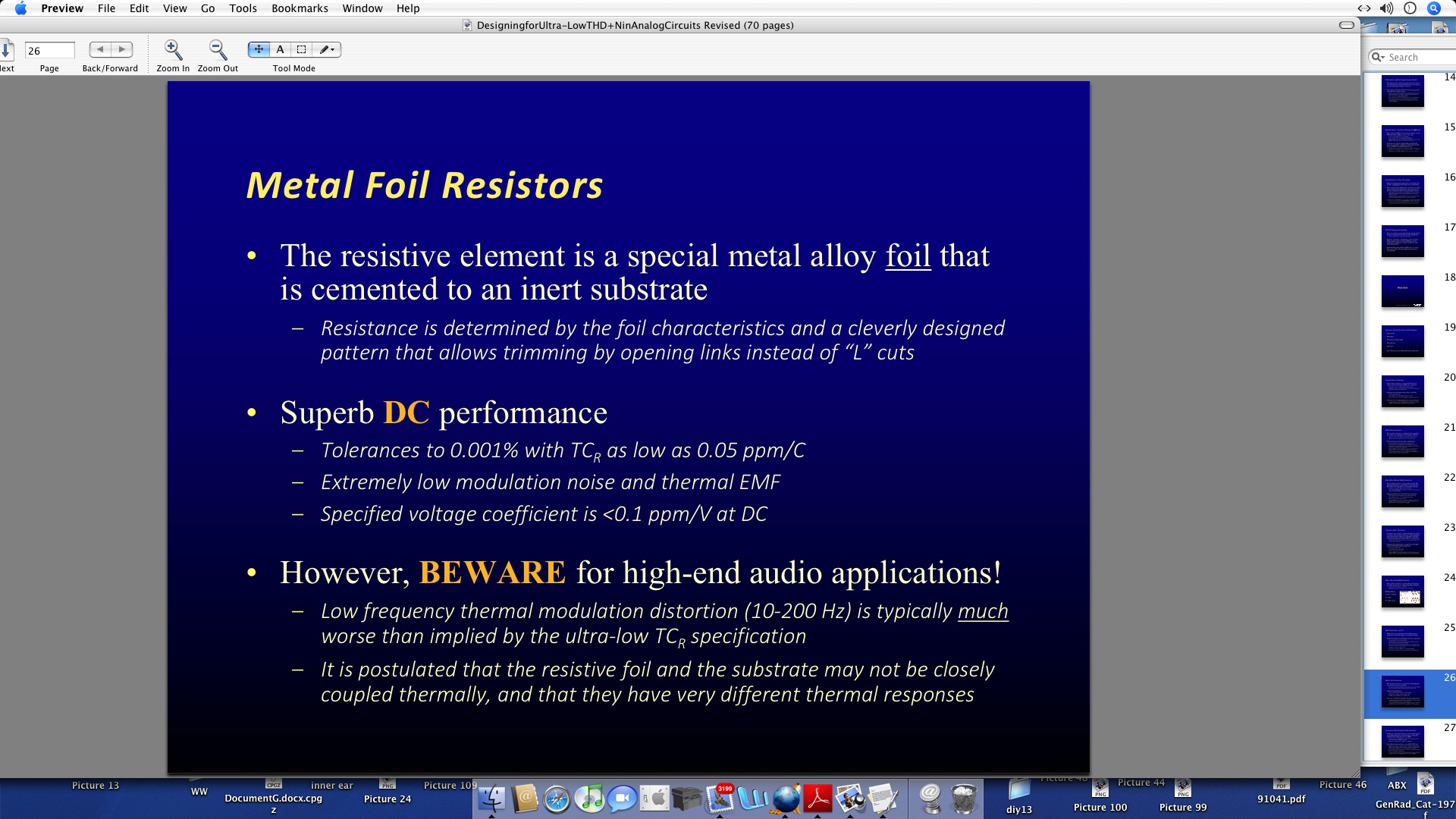

pulling up a old Michael Percy catalog I see 50 ppm Holco, Roederstein, Caddock film resistors being pitched to audiophiles along with the "naked Vishay"
seems like "respected by golden ears" doesn't exactly follow Hofer's findings for lowest distortion
those Holco are even worse than Bruce's "avoid the common 25 ppm/C grade in critical circuit locations..."
curious minds?
Like it matters 🙄 If one relies on tceff of resistors in a design for audible effect, surely the design would be considered suspect in most schools.....
It's designing OUT nonlinearity by careful component choice. These are important when you're down in the <-100 dB range. In an absence of numbers, it's hard to know how large this effect is (conceivably way below hearing threshold, especially since it's material at larger voltage swings (masking, anyone?)

Still ppm's or fractions of a ppm, the stationarity of a typical listening environment swamps this. That is I defy you to measure the frequency response or distortion of any speaker in any room to the ppm level from one minute to the next.

You might want to actually read the current presentation. Then we can talk about what distortion means. Low order harmonic distortion isn't that important. High order and non harmonic distortions really stand out.
I just love how he is now pointing to dC/dT as significant. That produces artifacts that can be totally unrelated to the signal.
Now the slides didn't get into dielectric absorption other than a touch on using capacitors at a fraction of rated voltage. And that clears up most dielectric issues.
He also covers things like power supply transients and loop area. But I didn't see any mention of why that also influences component selection. The thin film chip resistors also help decrease loop area.
It is NOT harmonic distortion itself that we look for. More, DYNAMIC resistance changes.
Many parameters change under voltage and current and freq and fields. About one hundred years ago (or was it 40?) I checked this issue of Volt Coeff and thermal as well...... I took a PA circuit with 100K fb resistor. it was worse than 100ppm but lets use that..... with +/- 50 v peak (100v p-p) across it, that would be an R change of only 10 Ohms......for one volt.... or about 1000 Ohms dynamic change at 100v. The Vas stage can have similar values and voltages as well as other places and circuits. Converted into gain dB's it is a tenth here and a tenth there. The over-all accumulated affect is less clarity in the micro-details of the music signal. So, yes, use <10ppm resistors and keep the voltage drop across them to low levels.
It really is all in the details now.

Those `super critical` resistors which are stressed with high AC or DC voltages across ends have to be divided at least in four connected in series , for example ,
that 100K Rfb res. have to be replaced with four 25K res.connected in series.
