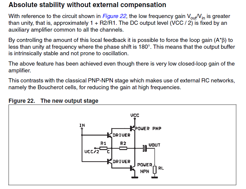

Maybe some misunderstanding here?hitsware said:Real amplifiers don't need it !
It was a humorous response (along with a circuit that purports universal stability) to my comment about a vehement hatred of Zobels (which was also tongue in cheek).
