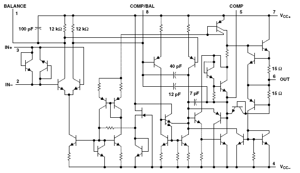

A pull-up resistor loads the Opamp so a constant current sourse is better.
Build an opamp linestage and try yourself if there is any change in sound. I have tryed the OPA134 with pull-up resistor to the negative rail and to the positive rail. I have played that circuit to visitors and made a simple A-B test. They knew when i made a change but i did not say what i did so in strict terms the outcome of this test is purely anecdotal because the visitors knew that i made a change and the experimenter ( me ) was in the room.

how about pull-up resistors on the opamp outputs ?
is class-a viable at line level ?
It's a pity schematics aren't available for the better opamps or some other trickery might be possible. E.g. looking at the NE5534 schematic, it seems like a suitable resistor (47R?) connected between pin 5 (compensation) and the output would bias it very nicely into class A.A pull-up resistor loads the Opamp so a constant current sourse is better.
I suspect something similar might be possible with other opamps having external compensation, but without a schematic it's guessing or trial and error.

A lot of tricks can be done to the NE5534. No, modern chips give that oportunity not any more mostly.
