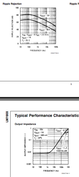

The ripple from the raw PSU is about 500 mV. The ripple rejection in LM7815 is typical 70 dB @ 120 Hz and 1A. Add to that 100 dB in the opamp. I think it's enough..
Two points of uncertainty:
1. What is the ripple rejection in LM7815 @ 30 mA load?
2. What about higher frequencies?
To force the opamps into class A is intriguing but somewhat outside this minimalistic approach. I would have used a constant current source for that purpose. A FET and a resistor, maybe.

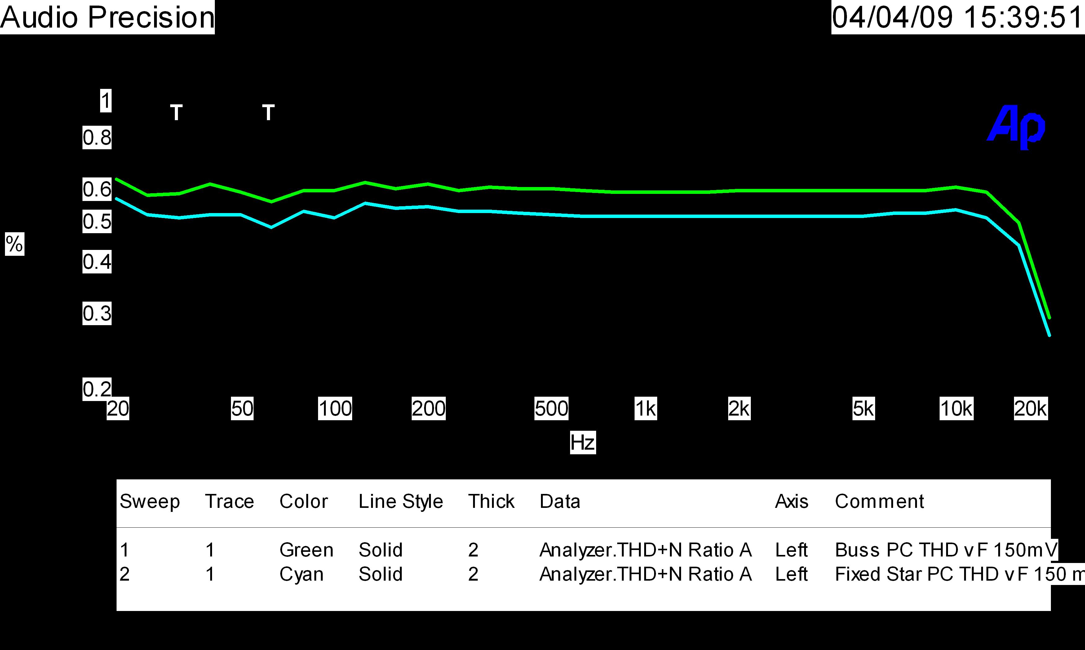

Attached is the measurement of the same circuit using two different PC layouts, one a star design the other a massive ground plane or buss style.
What SY is talking about is interesting, but relatively pointless. It is as if my Vendetta phono stage (in my $20,000) preamp has a top speed of 150 mph, and SY's tube unit has a top speed of 200 mph. There are places on this earth where this difference in speed could be useful, but not where I live, or how I drive. Therefore, it is a pointless addition to the design, but still one to be admired. After all, the speedometer in my Porsche only goes to 160mph, wouldn't it be more exciting to see 220mph on my dashboard!
Given your post on noise (the $20,000 unit was 25 times better than the opamp unit, which already has noise below audibility), and your condescending sneer at someone doing a layout of a good performing, affordable phono stage, my irony meter is pegged.
