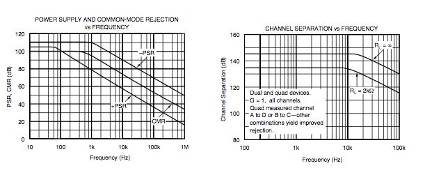

Just for completeness, here is the PSU rejection chart of the OPA4134 and the crosstalk chart. PSU rejection to the negative supply is better so we could tie a 5kOhm resistor from output of the lineamp to the positive supply. Then it runs in class A up to 3mA and we may get a better PSU rejection. Using Opamp A and B for the Phono and C and D for line we can get better crosstalk.

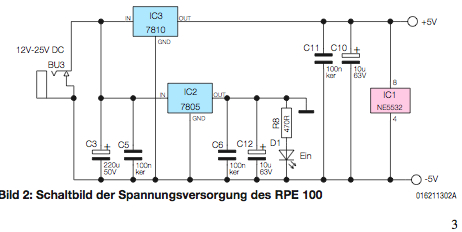

See also an alternative floating supply, this time with the regulators in series. This example gets only plus-minus 5V, so it has to be modified.
