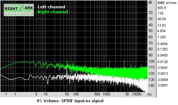

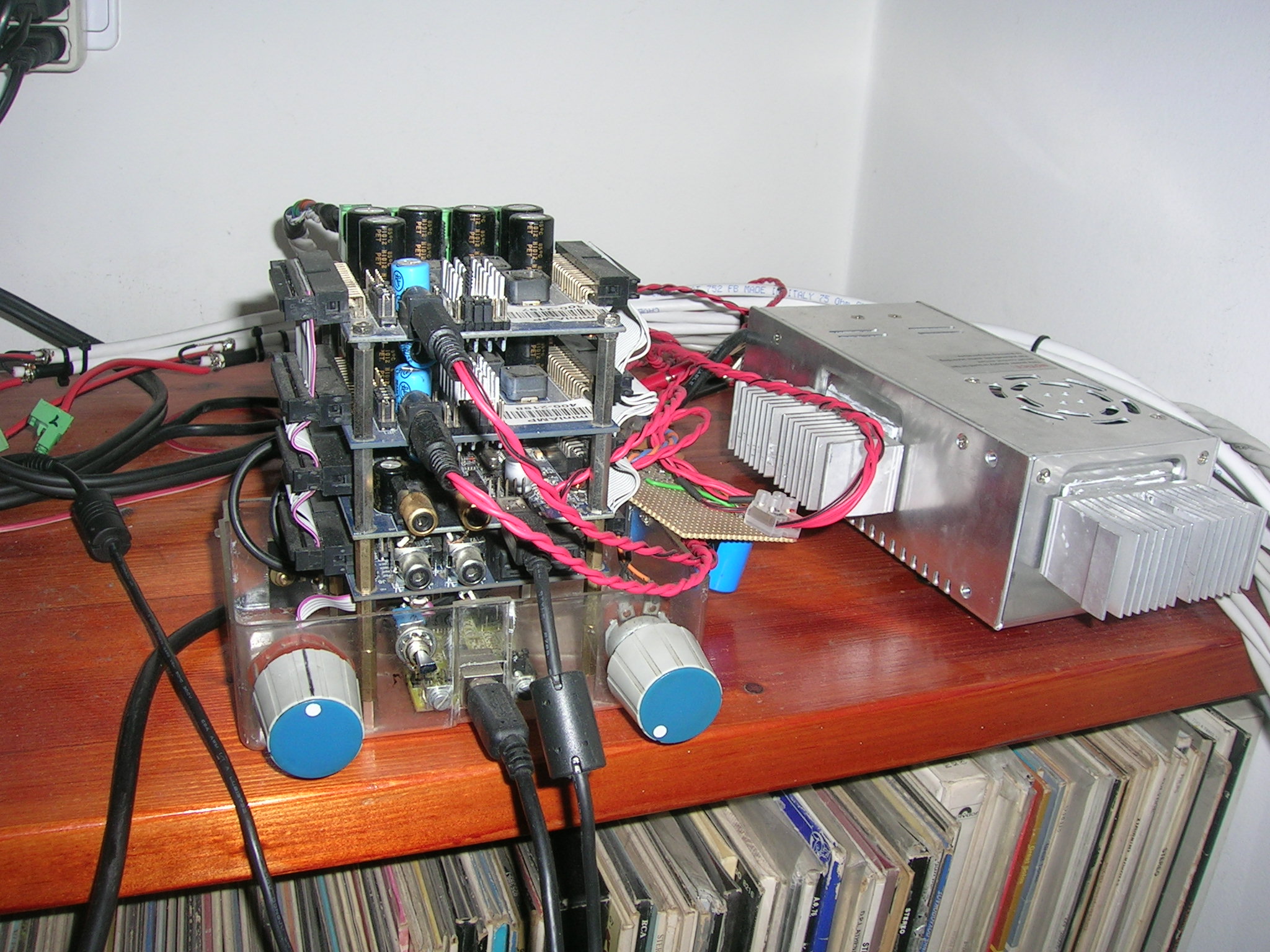

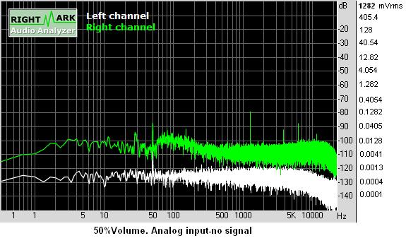

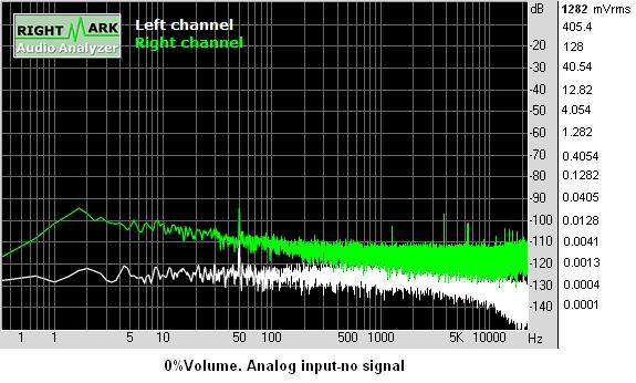

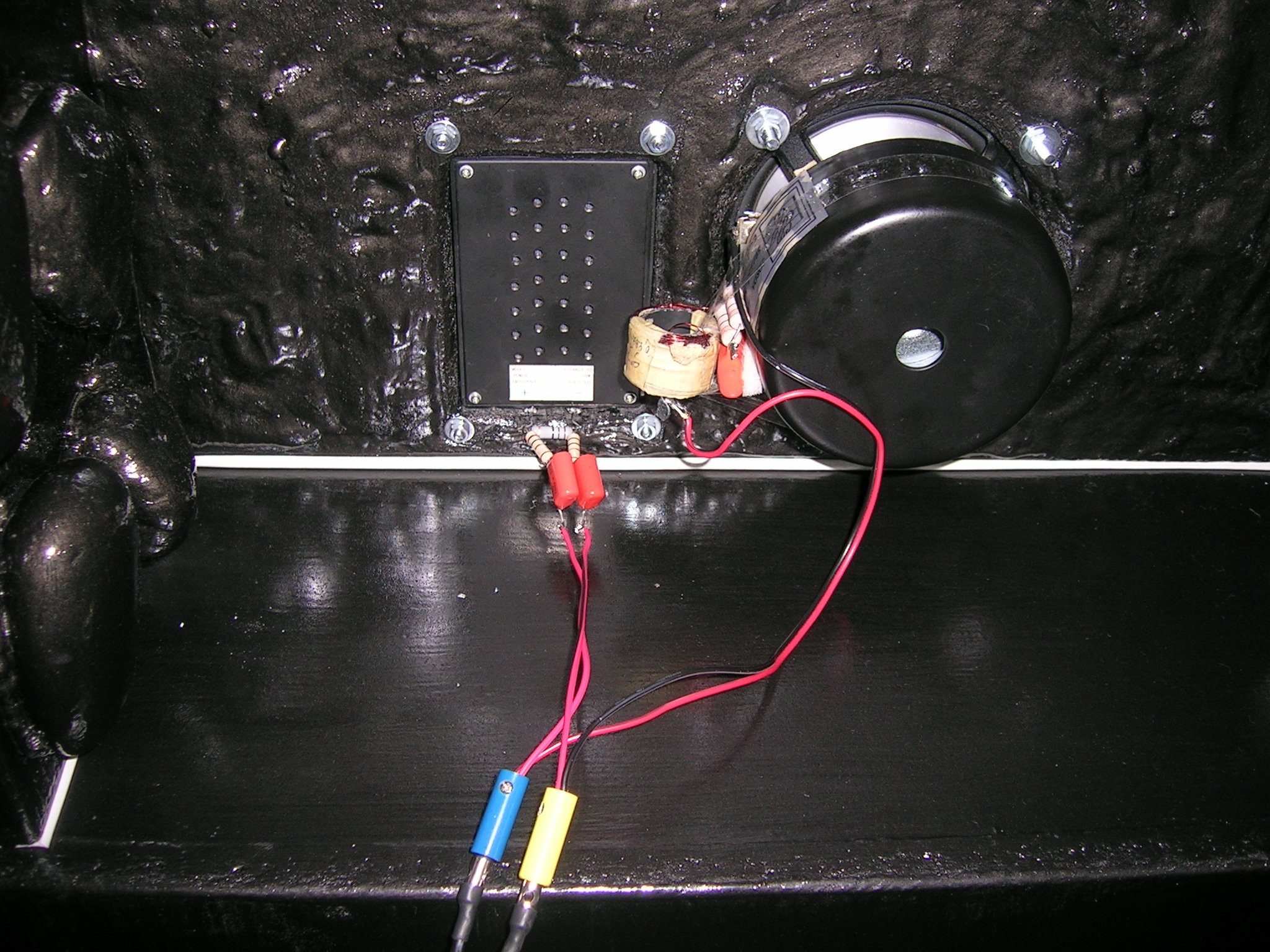

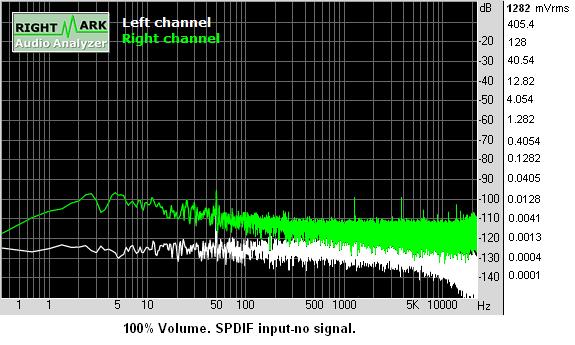

All that un-cased electronics and I don't hear Gpapag screaming "too much interference".
Andrew this the benefit of I2S boards interconnection. Total silence.
Green trace is amplifier output signal tapped at loudspeaker terminals.
Class D amp output is balanced, audio card input is unbalanced, so measurement was through a 1:3 step up transformer (AUSO ELA 75-03 213).
Therefore, the measured signal is 9.8dB lower than green plots show.
(MiniDSP x-over set to flat, no filters. Loudspeaker was a MLQW Jordan JX92S. Volume setting refers to digital volume of MiniDSP 2x4)
Attention to loop areas for both low current and high current circuits can make our systems quite interference tolerant.
All psu dc feed lines are twisted, as are the speaker cables.
