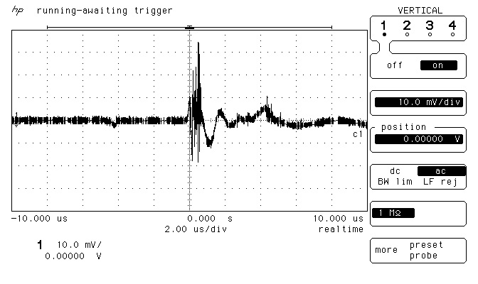

I just tried it both ways (with and without DC bias) and I got a reading on both with my scope and my HP339 meter.
a classic line.
If someone from Japan told you, he'd have to kill himself.
Classic is a matter of wind heading.
Notice something funny there?
Yes I noted something funny. You stated that you got no signal. I get lots. Everyone else who has tried it has shown photo sensitivity. The conclusion is very simple YOU ARE WRONG.
With the cardboard blocking the flash there is no signal.
Dmitri showed almost zero signal. Mooly got a minuscule signal. Your results look more than a bit funny, but perhaps you don't see why.
And note that the receiver in the PE project was not a forward biased diode.
No the only funny thing is you said you used a strobe. So did I. With a strobe the signal is not minuscule. Everyone else has a signal. Why did you not get one with a strobe?
You also stated you don't get a signal from a forward biased diode. Again not the results of the other folks. Why don't you repeat the tests and see where you have erred?
What part of the trace do you not know how to read or understand? Perhaps I can help you.
You are masterful at the "left out important detail." 😀 Hint: does one expect an electron to be liberated with the absorption of a photon?
TBH, I wasn't looking at -130dB with illumination right up against the LED, so it could well have been there. But since that's ridiculously low, who cares?
