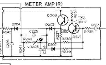

I have a silly question. How fast can you reliably drive a needle indicator? How fast can you get it to move into position and then stop exactly where it needs to be? Assuming you drive it with a network to compensate for needle mass?
To answer partially your question, just have a look of how Nakamichi (550) did-it (It was a nice peak meter for K7 tapes):
