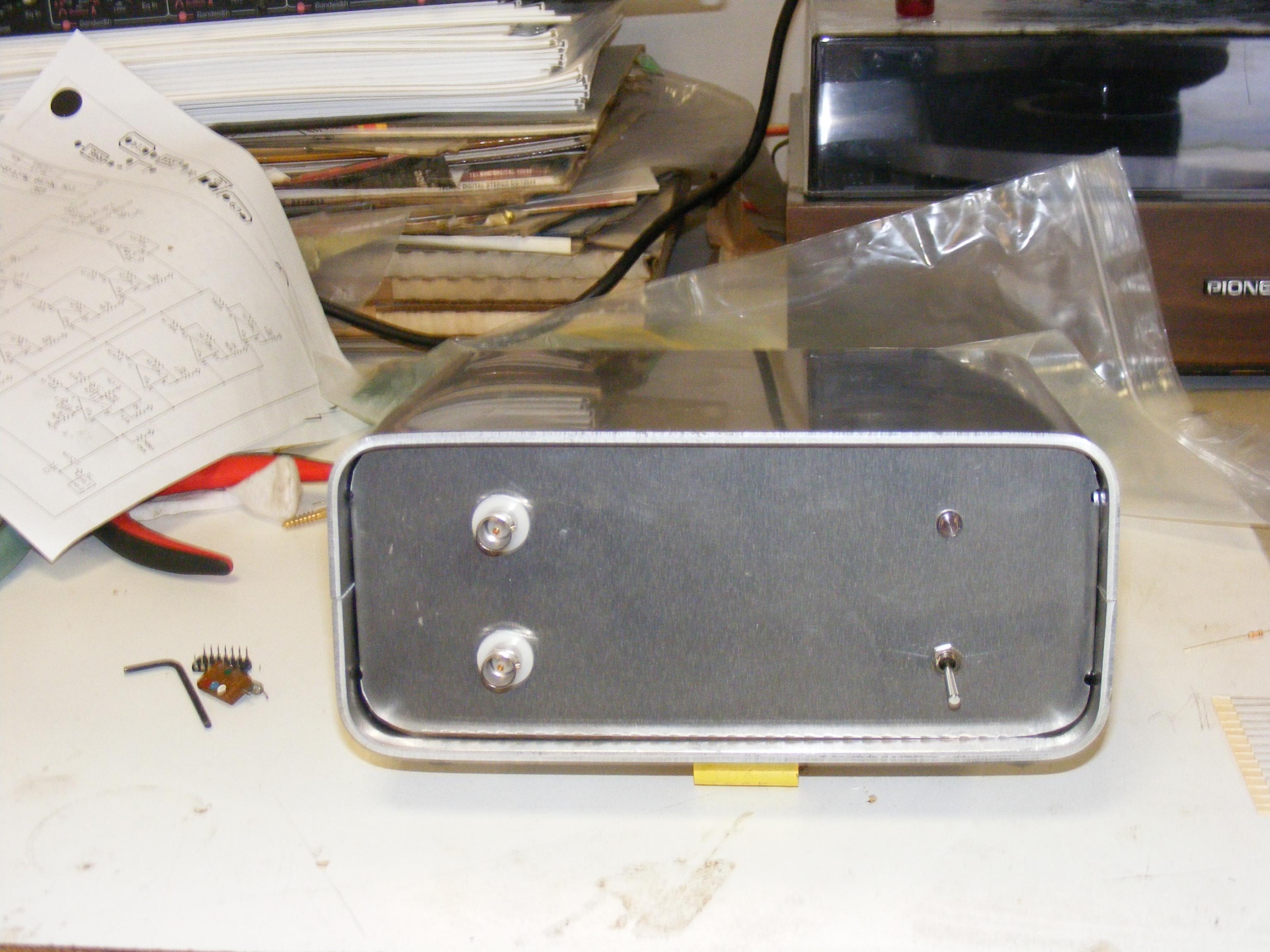

Attached is a picture of my prototype equipment case.
