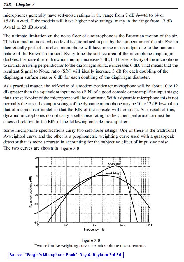

George,
You made me have to look up the word psophometric, now I know a new word. I wondered why the graphs were diverging so greatly. You can learn something new every day it seems. Thanks for the reference. I also now see that the larger diaphragms actually have higher inherent S/N ratios, I would have thought the opposite.

George,
I had to look that up myself (*)
The root is the verb ‘psopheo’ meaning “to produce noise”, the noun ‘psophos’ meaning “noise”, so “psophometric” means a process (here a measurement) that uses noise as the stimulus
Greek Word Study Tool
George
(*) In fact, the verb ‘psopheo’ was the opposite of the verb ‘phoneo’ that was used to mean “to produce a structured sound (human voice)”.
Thus the verb ‘psopheo’ was (is) used to mean the forced death of animals. It is used too for to describe a human’s uneasy death (slug).
You can learn something new every day, indeed! 🙂
