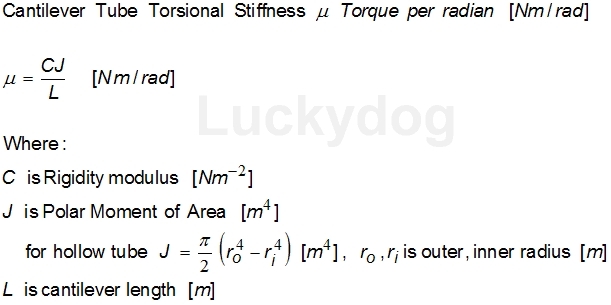

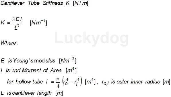

The challenge is simple: devise a cantilever as stiff as possible using a given mass budget. The aim is to make the cantilever move as a body, rather than flex, and when it moves as a body its mass matters.
See attached equation describing stiffness of a tube or rod cantilever. Stiffness depends on radius to the 4th power, and inversely on length to the third power. Then geometry totally dominates choice of material as to stiffness, at least between Al, B, Be and ruby.
Best answer for how to use the mass budget is to use as fat a hollow tube as possible, with as thin walls as possible, and make the cantilever as short as possible. There is far more action in changing the geometry of an Al cantilever than changing the material to B, Be etc.
Solid rods are a particularly poor use of mass if one works it out..........
So a short fat thin walled Al tube would be far stiffer than any exotic standard geometry cantilever.
Another pretty weird artefact of the vinyl world, exotic material cantilevers then....................?
See the images below for cantilever transverse and tortional stiffness equations, check it out.

If we have a typical Al tube cantilever, decrease its length and increase its radius by about 25% and adjust wall thickness to conserve mass, it would be as stiff as a B cantilever of the original dimensions yet have the same mass.What about Boron or Be tubes then?
The obvious thing to do to restore the gain is make shorter fatter B tube cantilevers, but we don't see those, if anything they tend to be rods and/or skinnier........we don't even see many short fat Al cantilevers.
Cantilever geometry as to length and cross section profile, rather than material properties, typically dominates stiffness per mass.
