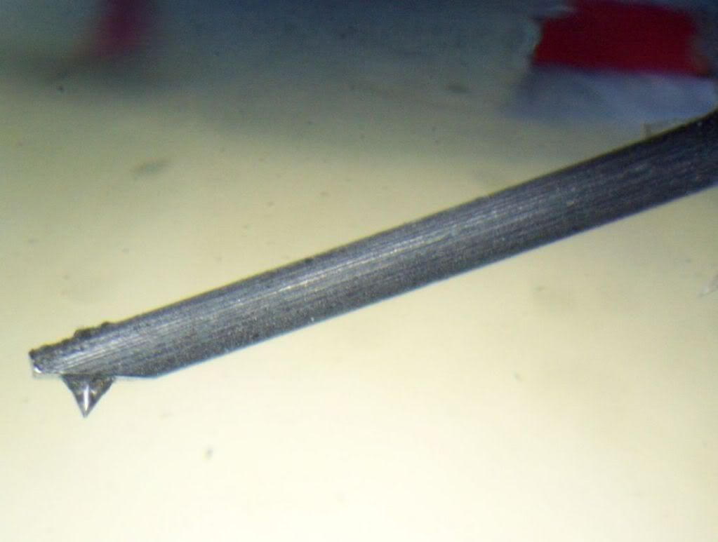

Not always ? http://i170.photobucket.com/albums/u252/fftulip/audio/Dyn30B_sty.jpg ;-)This is glued on ruby, so i assume with boron the same. It seems to be more glue than expected.
Yes, but the 30 B has a solid boron rod, no tube. ( some say ist beryllium, but most sources say boron)
Today laser drilling is possible, whatever material, but with alu you can press fit due softness, then adjust the diamond and then glue, minimal amount, boron is very hard (9,3 Mohs), density is nearly like alu, so there i see no advantage for solid boron, its more mass than a tube.
