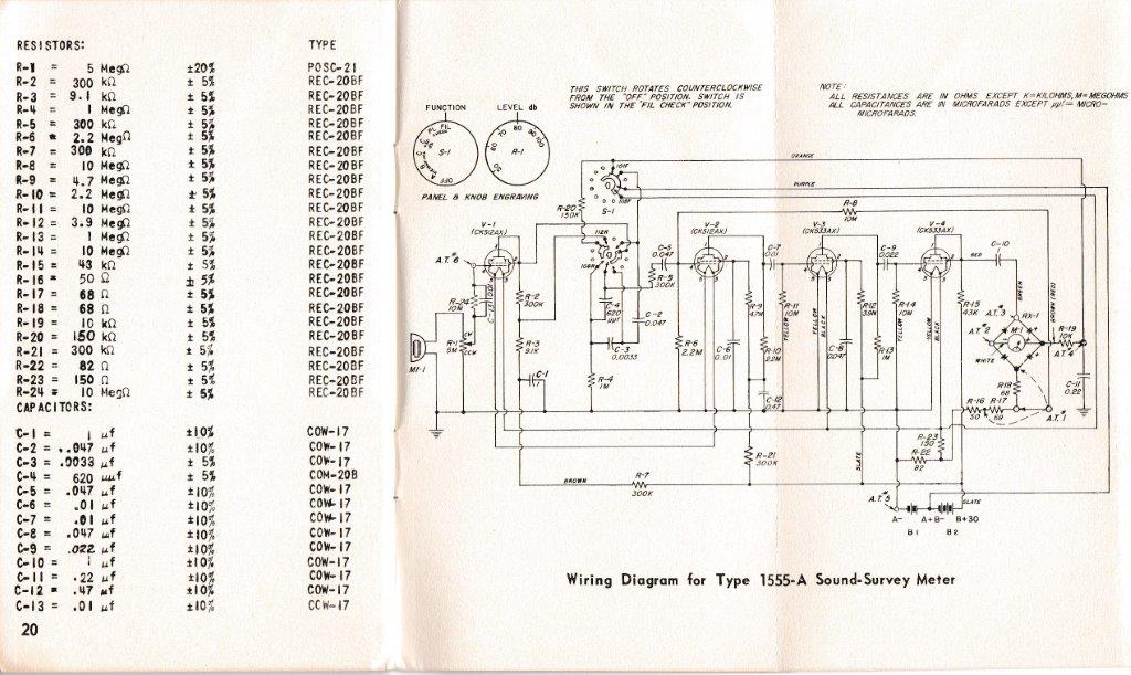

On a totally unrelated topic, I am currently going through my collection of five General Radio Sound Survey meters. I buy these on eBay for under $25.00 each. They are ceramic microphone, vacuum tube based handheld sound level meters. They are A, B & C weighted. My oldest one is serial #175, the newest #5352. Minor changes between them. Now I used to be able to get Eveready #413 30 volt batteries made in China, but they are almost impossible to get. However someone is making a modern alkaline version. As the good meters only draw 400 uA, the B+ battery life is good. The C cell used for the filaments also is used for biasing.
Now virtually none of the meters come in working condition. Many of the capacitors are metal case glass sealed oil paper, but some are unsealed. The normal failure mode is to find the plate voltage on V1 as shown in the attached schematic drops to 2 volts or so. I think from the schematic it is obvious were the issues are.
The reason why I like these meters so much is the sensitivity is set with a potentiometer. This allows me to set the gain so it reads zero during a pink noise system setup. Then anyone can identify where the level is off by more than (for example) 3 dB. If the sound source are 70 volt loudspeakers then any electrician can turn the transformer taps up or down as needed.
Now the unit does use pencil tubes and so far none of them have seen enough use that the tubes have failed. But I do have a source of new (old stock) ones.

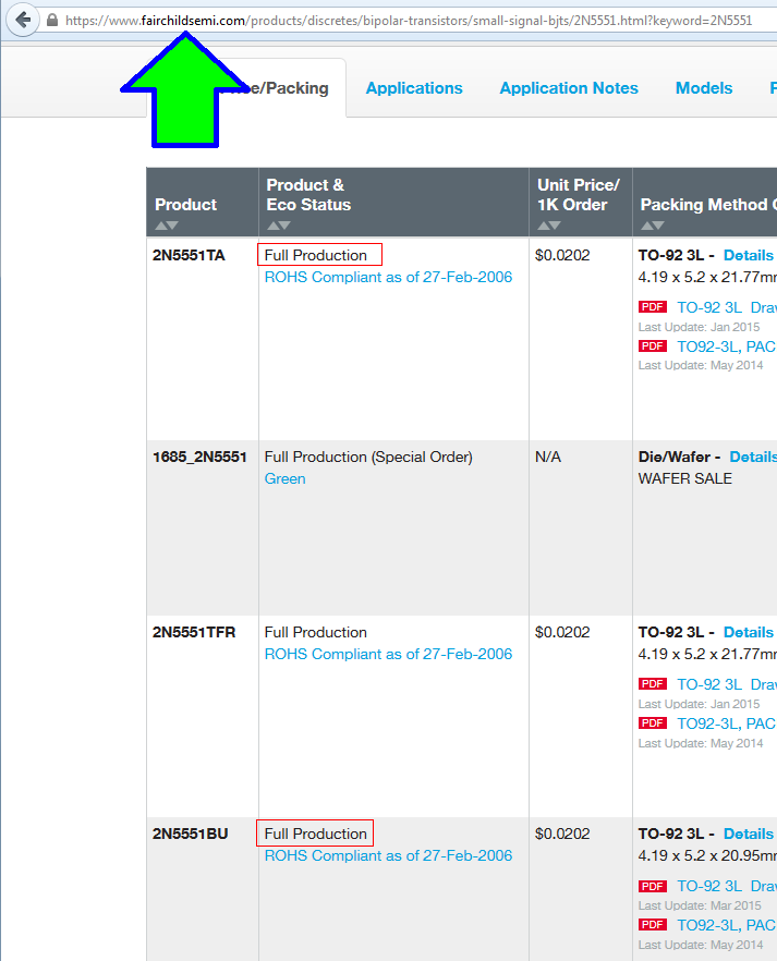

Well, I was thinking of the OnSemi parts which are the fastest out of the manufacturers. They are discontinued.
Also according the the On datasheet, quite a bit lower voltage and no beta bracketing. Best to avoid.
BTW be sure to check the pinout of the Fairchilds. There appears to be a typo in the datasheet for the numbering of the leads.

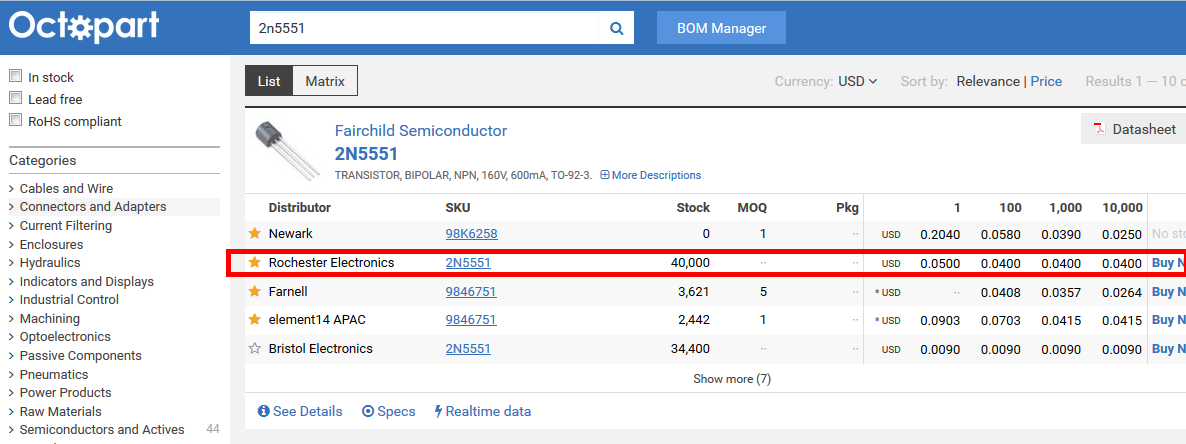

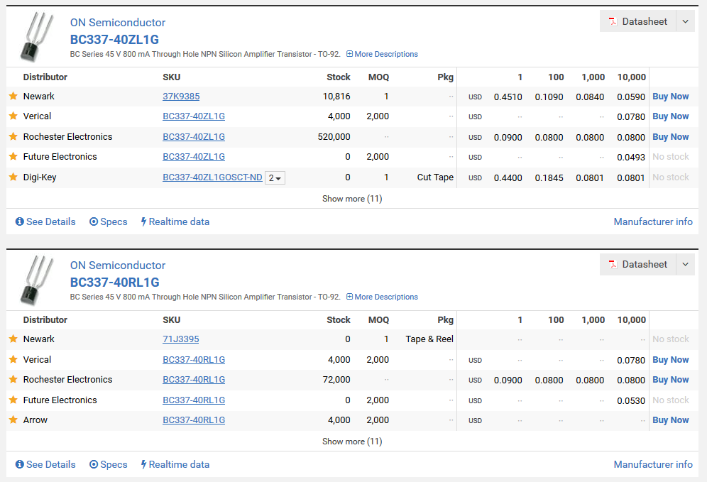

I've been extremely pleased with the quality I've received from Rochester Electronics. They are a US based company and their shipping costs outside the US are high. But I'm in California and I find the costs quite manageable.
Luckily they are indexed by octopart.com. Here is a small snippet from the huge amount of output provided by octopart.
I recommend purchasing at least 500 of each part type. To buy 500 NPNs and 500 PNPs you'll pay less than a bottle of Champagne at a fancy restaurant. You want to do this and do it now, if you're worried they're no longer produced.
