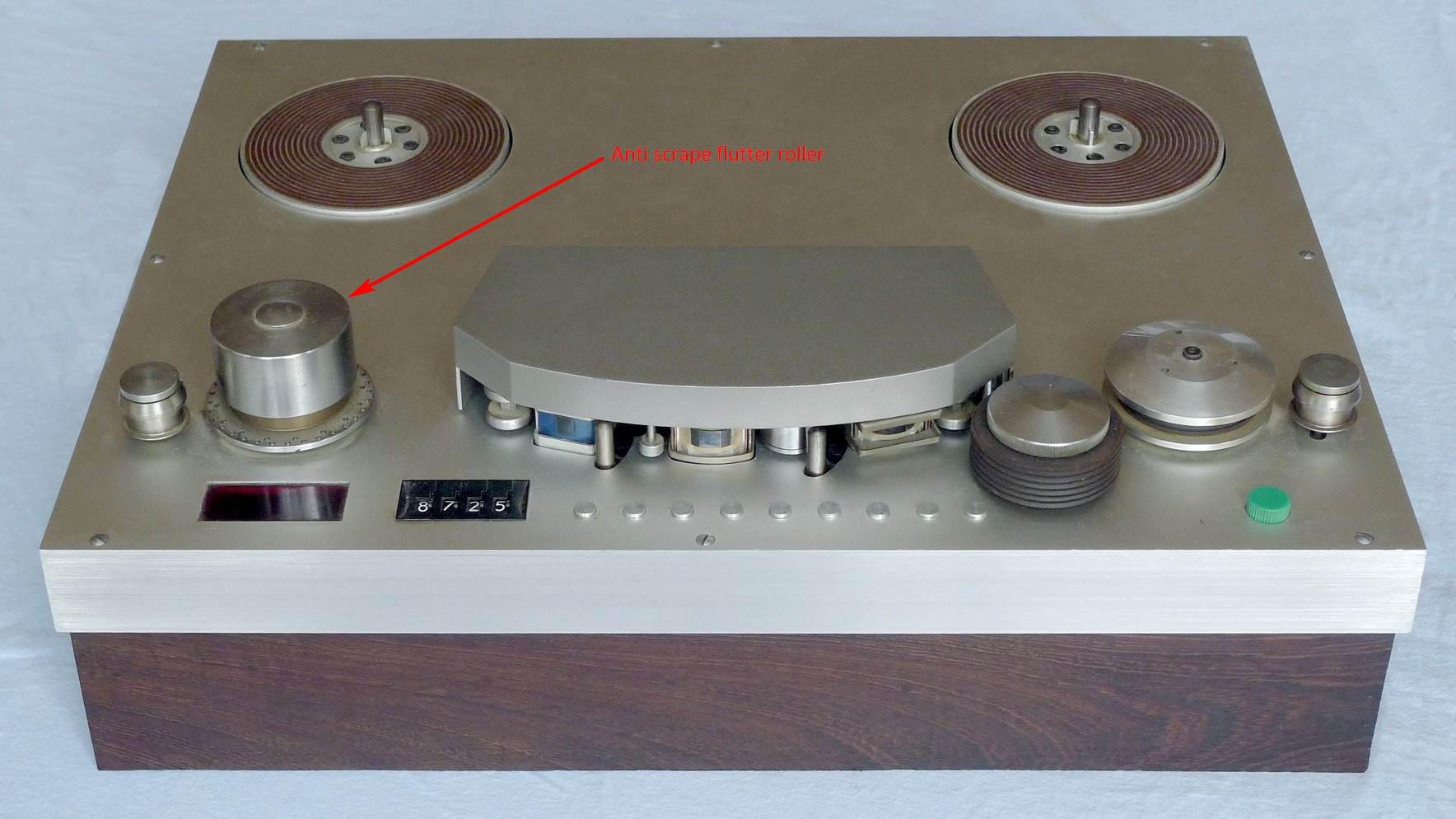

Scrape flutter is real. Some tape playback systems have less, depending on the addition of precision rollers added to the tape path.
Yes, it is! Even my homebrew tape deck has such a roller:
Edit: Actually, there are two of them: one more between the recording and playback head, though much smaller.

Tape binder was often responsible for tape scrape noise. It was an FM modulation (very physical) created mechanically. As a side note, Agfa could make almost any machine squeal, Studers included. The residue was not visible under normal viewing, but Methyl Hydrate would clean this off. Probably Ampex head cleaner would as well, nasty stuff!
Those rollers you are referring to were called impedance rollers by Studer and by some at Tascam. I worked with the studio tech at The Metalworks for a bit. Incidentally, Dave built a tape baker that would reset the binder allowing you to get at least one play out of old masters. The idea was that you dubbed the old master onto fresh stock in a one shot deal. I do know they rented that oven out to other studios. Apparently it really worked.
