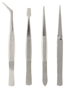

That's what I said I don't know of any automated handling equipment for 1" wafers ........t
I don't remember 1", but back in the day on 2" wafers we were all issued with:
I calculate one thousand, seven hundred, twenty six uA741 die on a 2 inch wafer.I wonder how many 741's fit on a 2" wafer?
This assumes the die size shown in the T.I. datasheet (45 milli-inches x 36 milli-inches), a wafer diameter of 50.0 mm (1968 milli-inches), and an exclusion zone of 81 milli-inches (45+36) around the perimeter. Estimation via rectal extraction.
