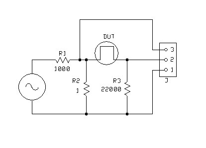

Attached is my test set up. I used an AP system 2 for the signal generator and have sent the signal across the cable both straight back into the AP set up to do FFTs and also tried it through a 1/2 step up transformer. The transformer version showed slightly different results but had lots of AC power line noise added.
(FFT Hamming window, 32K samples, 128 averages, .9F to 1.1F or tighter. Signal generator set for 7 volts.)
I tried test frequencies of 100, 300, 1K, 3K & 10K. I used two different cables. One was a 3' piece of 10 gauge THHN the other 3' 26 gauge 7 strand tinned copper hookup wire. Both pieces were folded in eighths to decrease loop area.
Probably will rerun with different current levels through the D.U.T.
Now the voltage out would increase with signal loss through the cable.
Just for JN the return path was the 22K resistor with total length under 2." The whole setup was built on the XLR connector without the shell.
Scott, I suggest you try this yourself.
