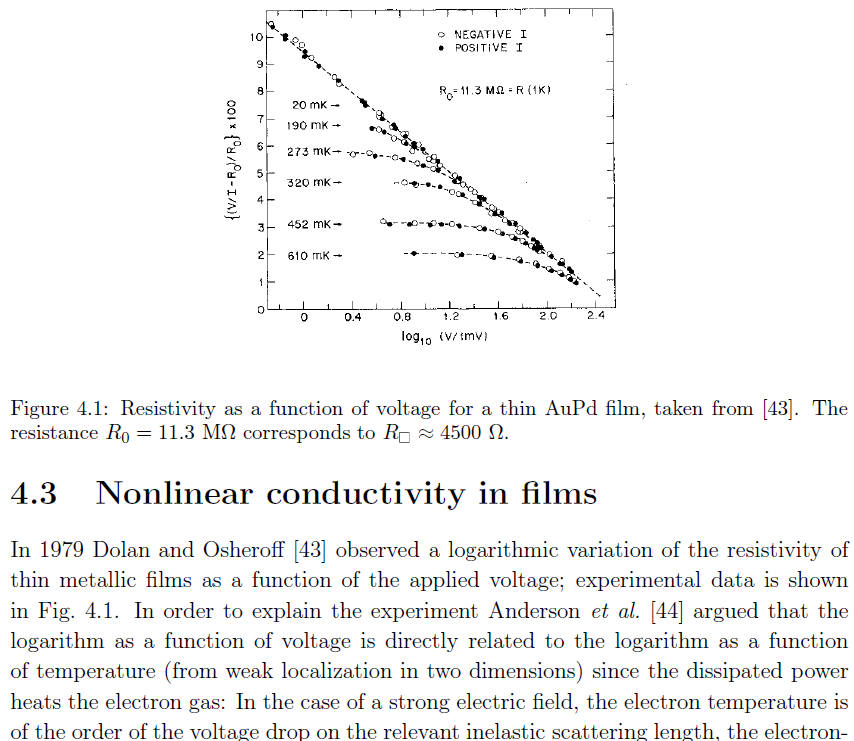

Yes, but how many of you people actually looked seriously at George's contribution of "Electron-electron interactions..."? Get up to speed guys!
do you mind slowing down enough to answer:
why? are you now designing liquid He cooled MC preamps?
if you even skim the paper you will find an equation with abs temperature K^-3 dependency for an effect that is ~1-2% at 610 mK
what's 2%*500^-3 (hint: I had to change my 10 digit display calculator to engineering exponential mode)

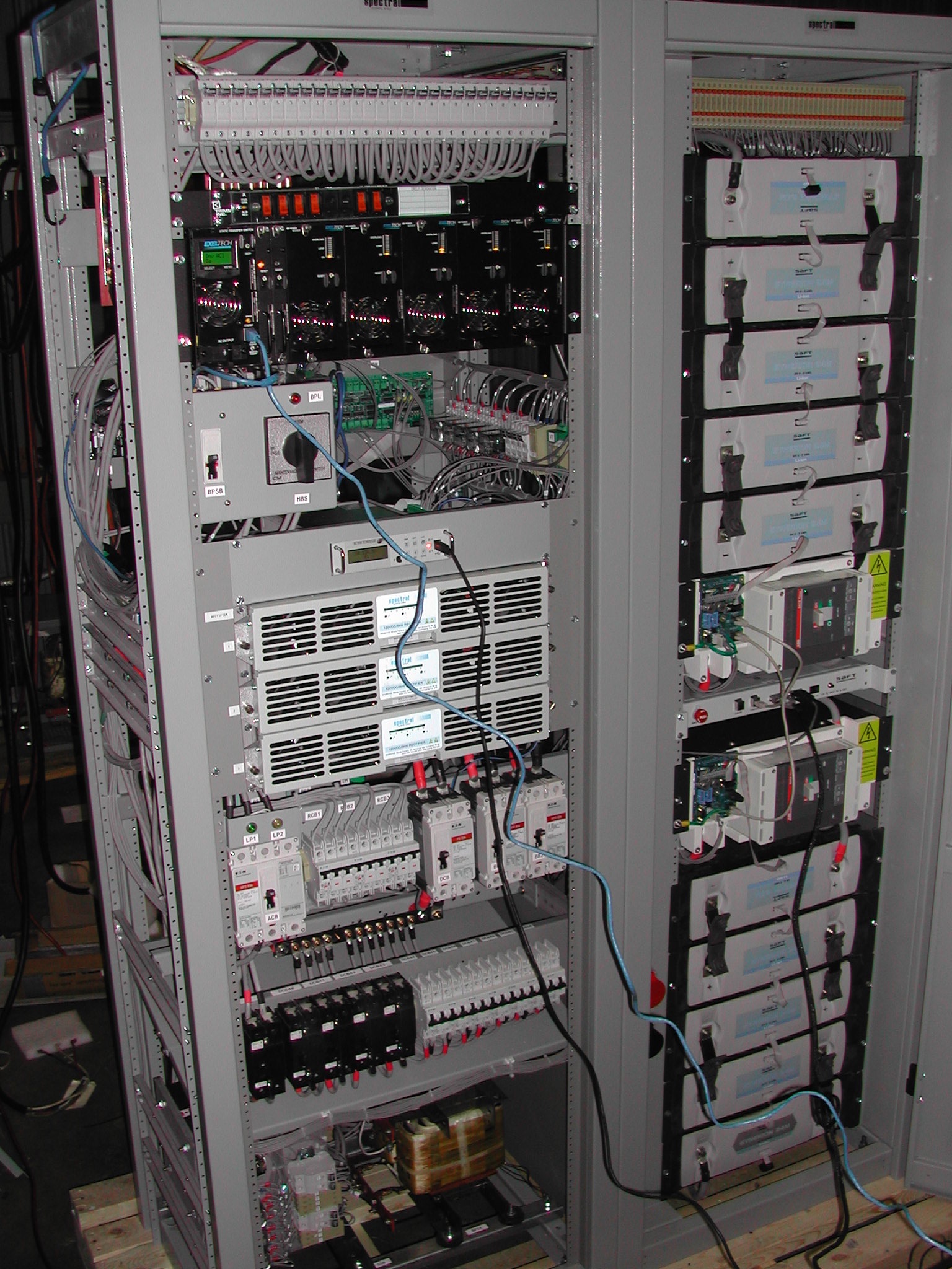

The telecom/cellular industry runs on well filtered SMPS from 250 watts to 100 kW at 24,48, 120, and 240 VDC. Output and input EMI conducted and radiated are both low and units are paralleled for redundancy and capacity. The pricing is too high for application in audio.
Here is a picture of the high end type of this type of product with internal AC transfer switch between 2 AC sources, an internal 30 kva dual electrostatically shielded front end transformer, 3 phase 6 kW switch mode rectifiers running in parallel with less than 1 watt of electrical noise, DC dual paralleled lithium ion 125 VDC batteries, paralleled 1 kva inverters, DC and AC distribution panel with SNMP and Web monitoring of all functions. It is one of the first industrial applications of large size lithium ion batteries in the U.S.

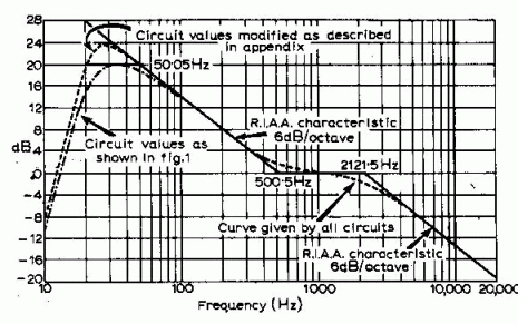

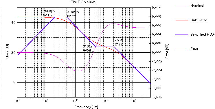

There were many reasons to roll off the bass in RIAA/Phono. One is from the commonly used standard ---
Question.... How was the RIAA LF roll off practiced in circuit designs of the LP era?
Question..... did it ever cause a voltage drop across the cap from the unwanted freqs?
THx-RNMarsh
Personally, I don't agree with electronically rolling off the bass of the phono preamp. It is best done with the 12dB resonance in the arm-cartridge (compliance) combination.

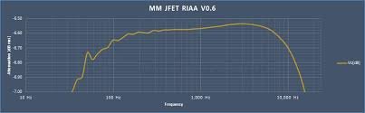

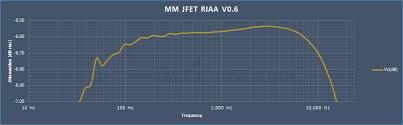

Well, the vast majority of phono stages in SS equipment and receivers used a polar electrlytic cap in a couple coupling places to do the job.
For someone who had a newer high-end system.... maybe it can be eliminated..... with the SOTA turntable etc. But often you get something like this as a result:
