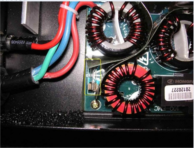

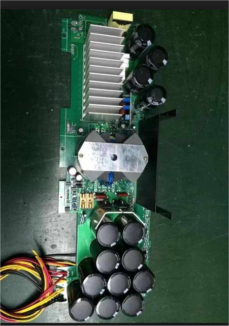

If I were needing an "anal" SMPS , some hobbyist's are cloning the Lab gruppen
SMPS in full form.
Lab G shields the entire package in the FP14000.
It looks like LabG uses multiple L/C common mode input filters/output
filters (below 1) , They seem to go way beyond the "normal" smps by
design (below 2) Ha ! An Alibaba chinese clone already !!! ...
Since it is being cloned , I'm sure there are variants (smaller) out there.
OS

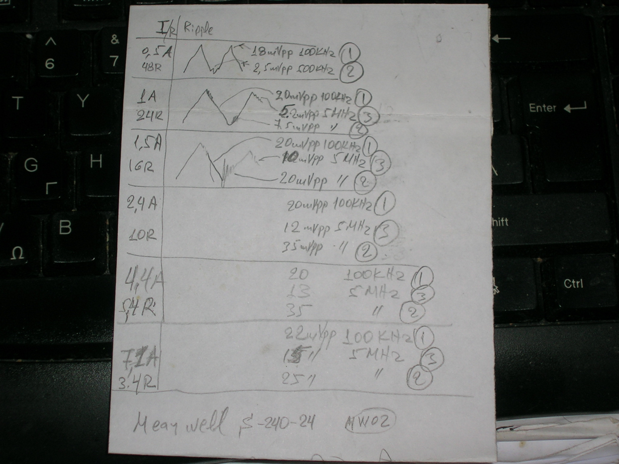

I use them for years (line level and power amp). Attached are some AC measurements of 24Vdc output with different load and amperage I did a decade ago (I have to do a decent FFT).
DC regulation is excellent. You see the stable ripple at the switching frequency (100kHz) and with heavier load you see spikes at ~5MHz increasing.
