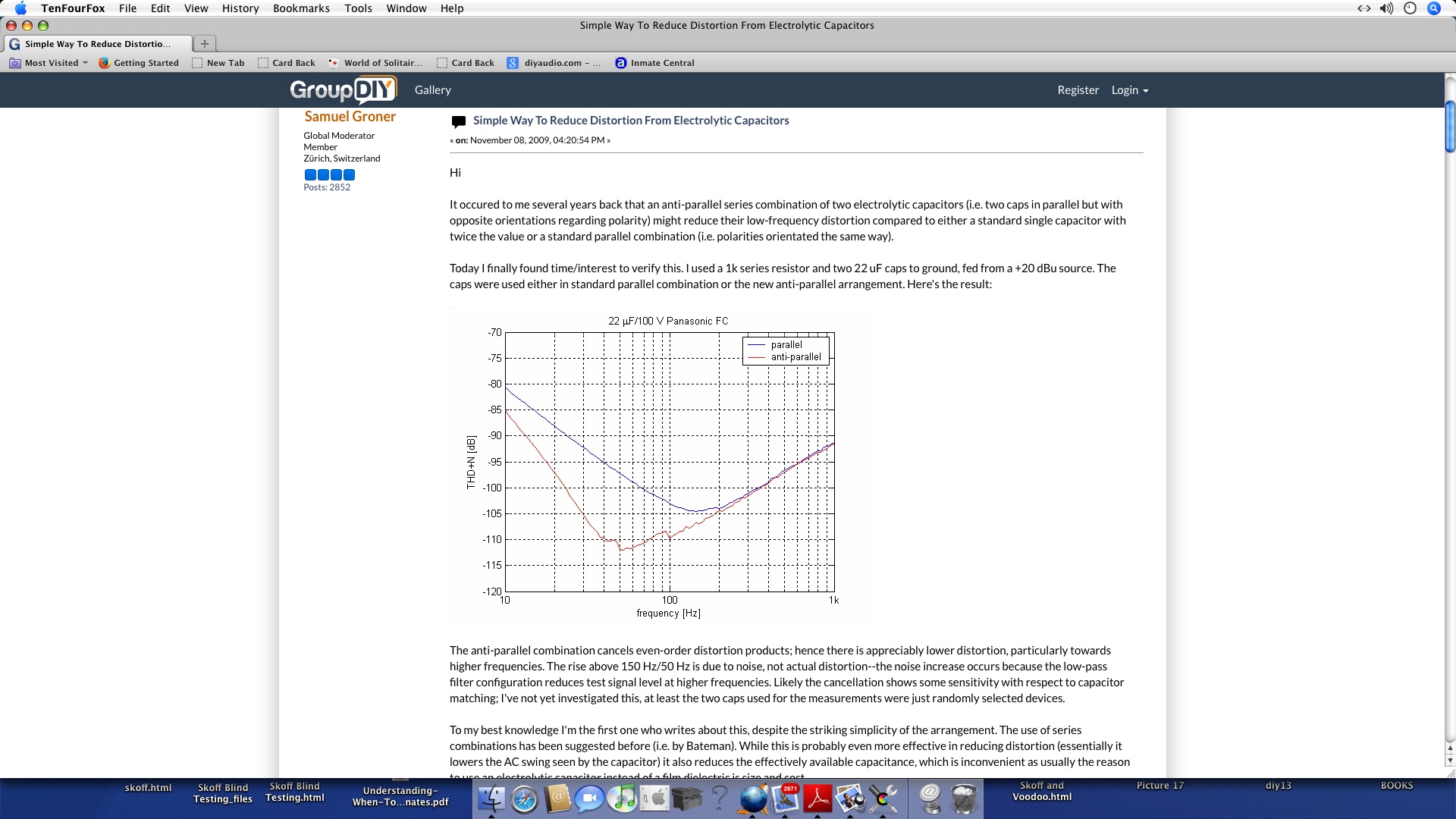

The test with triangle wave nicely shows creation of even harmonics (they do not have to be there) in the signal with unipolar cap. With 2 caps in bipolar connection, no even harmonic products appear.
Observation1:
This what Samuel Groner also found with his resarch
That even using two polar caps back to back lowers distortion
and is better than tantalum capacitors. Samuel was discussion
lowering distortion and which capacitors to use. He observed
using Bi polar caps as better and stated that even using the
polar electrolytics was better and had lower distortion if nothing else.

Here is what Samuel Groner did with anti-parallel caps. Of course, SY will not criticize him. '-)

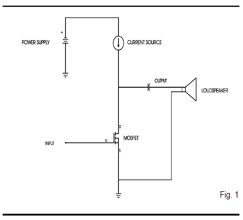

The Pass'ter
Simplicity is not the only reason for the use of the single-ended topology.
The characteristic of a single-ended gain stage is the most musically
natural.
Its asymmetry is similar to the compression / rarefaction
characteristic of air, where for a given displacement slightly higher
pressure is observed on a positive (compression) than on a negative
(rarefaction).
Air itself is observed to be a single-ended medium, where
the pressure can become very high, but never go below 0. The harmonic
distortion of such a medium is second harmonic, the least offensive
variety.
[broken up for your reading pleasure]
http://www.firstwatt.com/pdf/art_zen_amp.pdf
Ol'Skhul '94!
PS I'm sensing that biased, large value electros (Silmic II, mmm) are a good solution.
PPS No wonder I love all my simple, single-ended pre and PWR amp cicuits! (OK, I've gone too far ...)

I understand what you are saying but I do not understand what the fact that air is SE has to do with the DA and cap discussion?

OK, but you can avoid such distortion, quite easily, without creating high order distortion. This "nice" distortion also creates intermodulations that do not sound nice at all, especially with more complex music program. Distortion is not a good thing, though I may agree that this one will probably be naturally masked by the speaker distortion.
But being so low order, the intermod is more benign as well, even without any potential masking from transducer distortion. And in my opinion, if it's not audible under real world conditions, it may as well be "distortionless" for all intents and purposes.
The circuit by the way is a headphone amplifier. On the front end is a 1:5 step up transformer, which provides all of the voltage gain. It drives a simple JFET/bipolar darlington emitter follower fed from an equally simple single bipolar constant current source. Power supply is single-ended as well and the follower's output is biased at 1/2 the supply voltage through a single polar electrolytic.
When the measurement was taken, I believe it was driving a 32 ohm headphone that was playing quite loudly while sitting on the bench.
