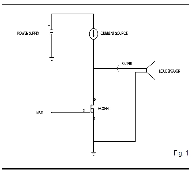

What's so special about air? Just one of an infinite series of possible dielectrics. ...
Well it is single ended.
The Pass'ter
Simplicity is not the only reason for the use of the single-ended topology.
The characteristic of a single-ended gain stage is the most musically
natural.
Its asymmetry is similar to the compression / rarefaction
characteristic of air, where for a given displacement slightly higher
pressure is observed on a positive (compression) than on a negative
(rarefaction).
Air itself is observed to be a single-ended medium, where
the pressure can become very high, but never go below 0. The harmonic
distortion of such a medium is second harmonic, the least offensive
variety.
[broken up for your reading pleasure]
http://www.firstwatt.com/pdf/art_zen_amp.pdf
Ol'Skhul '94!
PS I'm sensing that biased, large value electros (Silmic II, mmm) are a good solution.
PPS No wonder I love all my simple, single-ended pre and PWR amp cicuits! (OK, I've gone too far ...)
