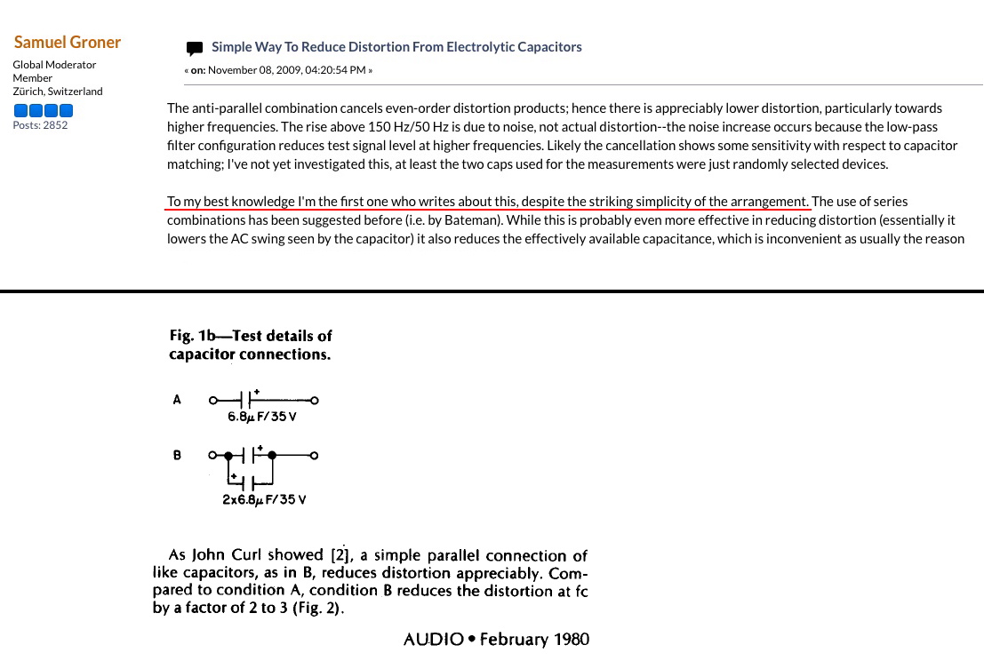

Here is what Samuel Groner did with anti-parallel caps. Of course, SY will not criticize him. '-)
Ha ha!
"To my best knowledge I'm the first one who writes about this, despite the striking simplicity of the arrangement."

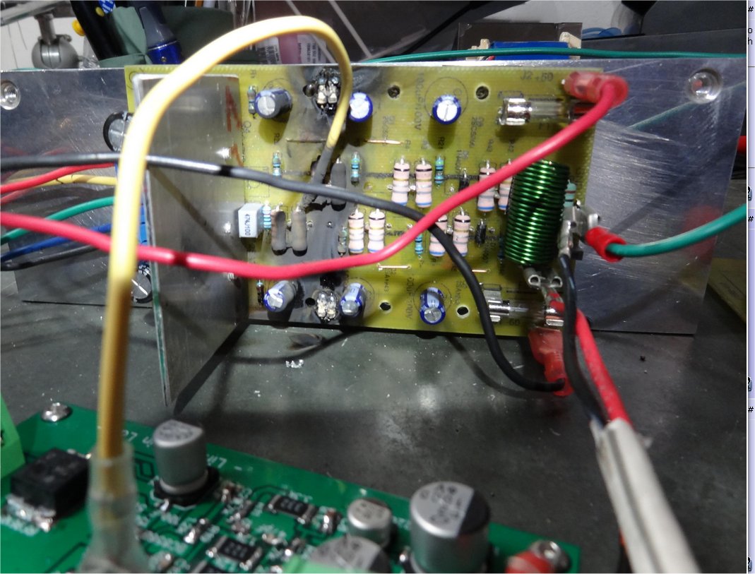

No , this is (below). a little "magic" ....
OS
whattdayamean?
Maybe....it USED to be Magic,
BUT
You let the SMOKE out!!!!
Now what do we do?
I did notice you had very good left and right balance!
Looks like the two lower and two upper (left and right channel)
resistors fried at the same time.
OR
Was it still running and you wiped them off to get
better measurements from them?
