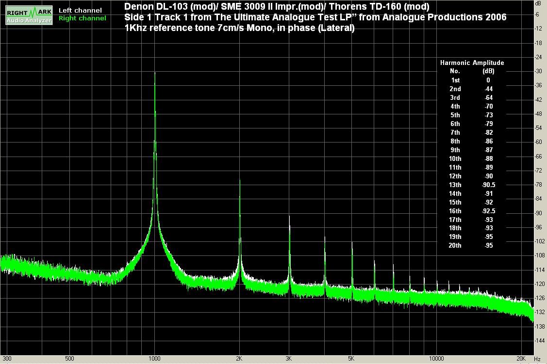

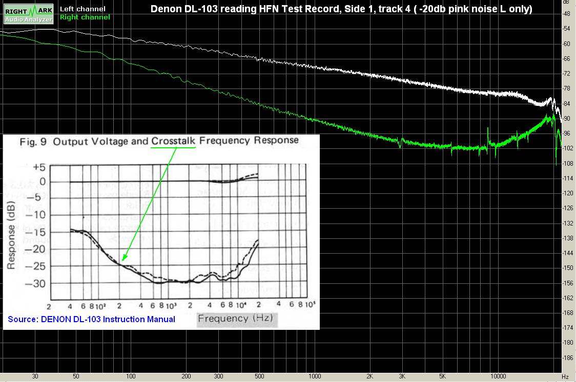

And don't get me started about 40dB max channel separation and THD nobody would accept in his electronics. See attached for a typical sample.
Add to this that this 40dB does not hold across the audio band (at least, channel separation is not a cardinal spec)
Jan, any chance you can borrow some time on the laser TT? I would love to put to bed the doubt that the tests tones actually are/aren't distorted themselves. For 30yr. no table/arm/cart combo has ever bettered ~-40dB levels for me.

My assumption is that at least 1/3 from the HD we read back is already in the grooves (and this for cautiously cut test records).
These were remarkably good for a 1900 technology, remarkably bad for a 1985 technology.

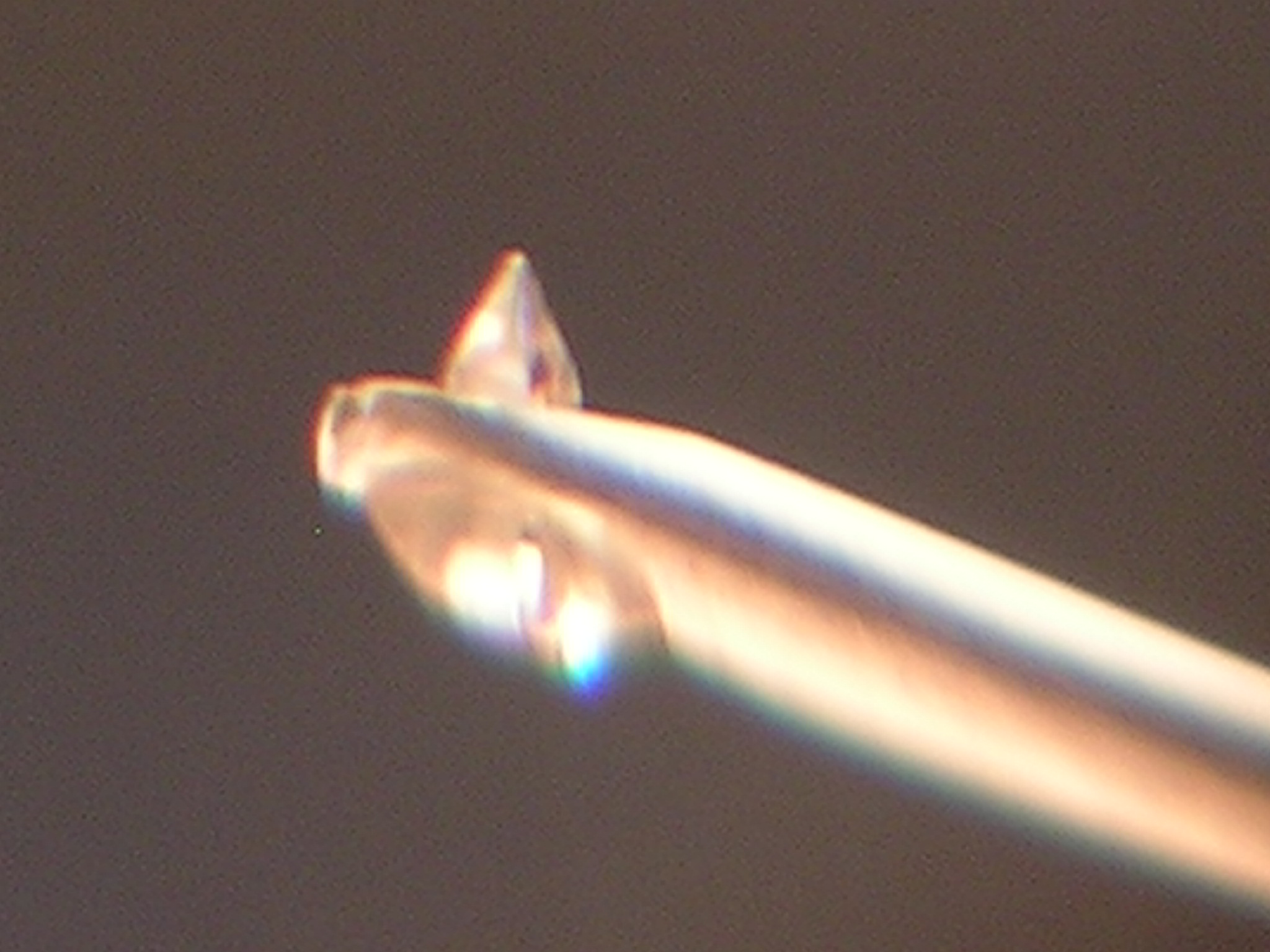

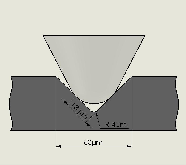

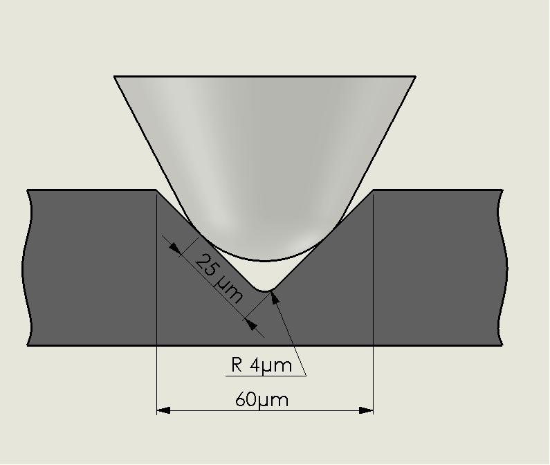

17 µm spherical tip (nude diamond).
A bit more distorting (in theory) due to pinch-off compared to a line contact profile but otherwise, it is the proper tip shape and size for the vinyl records I am interested in (O.K. I am often in need for a 25um spherical mono cartridge)
