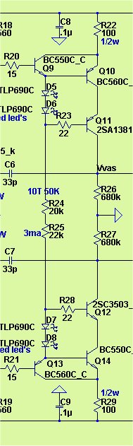

A prime example of added complexity affecting the "personality" of the
semiconductors is the Baxandall (super-pair)/Hawksford VAS on my last
"attempt".
The Hawksford nearly eliminates the early effect "personality"... and the
Baxandall eliminates load , saturation , reduces Cbb.
All this for just a benign added pole. GOOD tradeoff.
Group delay also rises slightly , but we end up listening to a voltage
stage with no bad "personality" !
OS

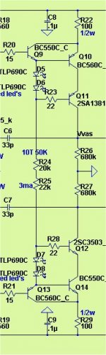

Control-electrode recycling is almost a free lunch.
Yes, almost. Had one VFA that did not "like" this "fancy" VAS (below).
It had twice the CLG of the CFA's that do well with it.
The effect (below 2) on the current of the baxandall base stopper
was magnified greatly with that VFA.
On the CFA's , nothing .... even on a 100mhz oscilloscope ??
OS

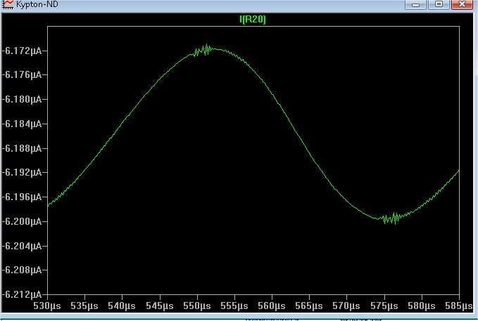

OS, that looks like your timestep is too large. it may do something different if you decrease the timestep by 5 times or so.
My timestep=numsampleOS, that looks like your timestep is too large. it may do something different if you decrease the timestep by 5 times or so.
numsample is ( .param numsampl=simtime/Freq/((simtime/numcyc)*FFT).
Variable ?
OS

A quick question about your power supplies (V1,V2). Do you include any series resistance in those voltage sources?
+1You have to separate series from parallel application of active devices. In my world, parallel is OK, complementary is OK, series is problematic.
Would you expect this to change anything ?
Your question - I did not in that post , but have done so now.
When I build something like this , I would have overkill cap multiplier's
"hugging" that buffer.
OS
