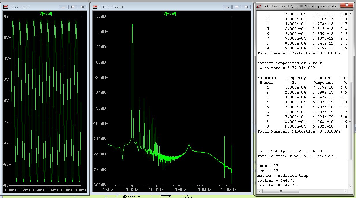

OK ... I crippled this line-stage.
Rser= 2R and FFT= 65536 (X4) , load = 33R.
THD went up a bit , still real low (below).
Residual "hash" became finer >100K , tried all of LT's 5$+
low noise FET input op-amps ... all below 1ppm any frequency.
Only allowing the buffer into class B could get me "normal"
distortion readings.

The buffer should be pure class A @ 100ma bias.
Enough to run an amp input and maybe even headphones.

I don't think so, distortion is very low to do that.

2R are emitter resistors on the output?
Nope ,Series resistance instead of an ideal voltage source.
10r emitters and a 33r load.
